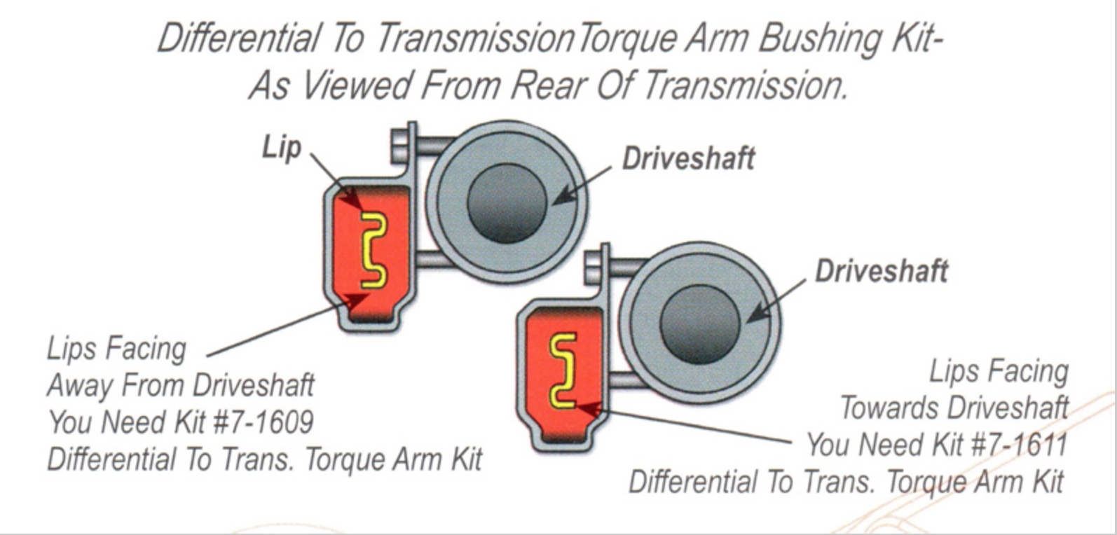

It is very possible.
There are 2 torque arm bushings for these cars. The only difference is which way the "W" feature of the arm itself, inside the rubber, is turned.
The other ES part #, for the one turned the other way, is 3110.
As far as I am aware, we have never figured out which cars got which bushing. It is not related to year model, engine/transmission, assembly plant, or any other obvious characteristic. We've all learned to order both and keep the one that doesn't fit the car we're working on, in case the next one we work on needs it.

It doesn't fit really "right" when it's turned around, but if it works, then ... it works.
If it was me, now that I know which one is right, I'd order it; and next time something else in that part of the car has to be disturbed, put it in at the same time.

Here's the orientation.
