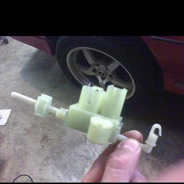

Clutch start switch
Anybody know where i can get one? I need one asap mine is broken, cant find it in my local autoparts and or chevrolet dealer

I don't know where to get one aside from maybe ebay. I do know that in the mean time, you can jumper the Purple/Yellow that plugs into that and be on your way. It will however, crank in gear if you're not careful.

I tried ebay couldnt find it, im guessing ima have to bypass it for now while i find one, thanks for the tip

What's broken about it?
Doesn't look like it broke the way mine eventually did; the end where the shaft thing plugs into the hole in the pedal, wore completely through.
Maybe there's some way to repair / rig it?

If it's just broken plastic, and a clean break at that, try Loctite 495.

^like he said some good lock tight. That's how I fixed my turn signal!
Wrecking yards is a good choice too
This is just a picture fore refrence, the whole little arm is broken on mine
