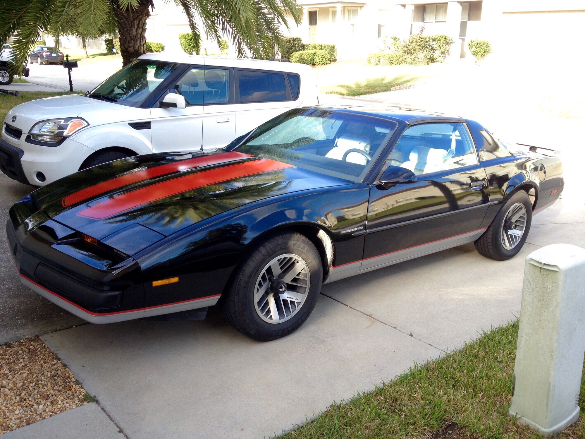

Hey everyone, I'm new here. So, as my first car, I got an '89 V6 Firebird. After a new factory spec paintjob, as well as some red stripes and some small fixes, it was running great, and I grew really close to it. After a while, though, some serious issues presented themselves. One, the car would shut off when the idle went too low. We set the RPM higher and fixed the first issue. Two, randomly when it ran, after a while of driving, when you pressed down on the gas pedal, the car would no longer accelerate, and would make a sound as if you were pressing down on and releasing the gas pedal in neutral. VrOOOooom... vroooOooommm... And the only way to fix it seems to be to turn the car off and back on.
