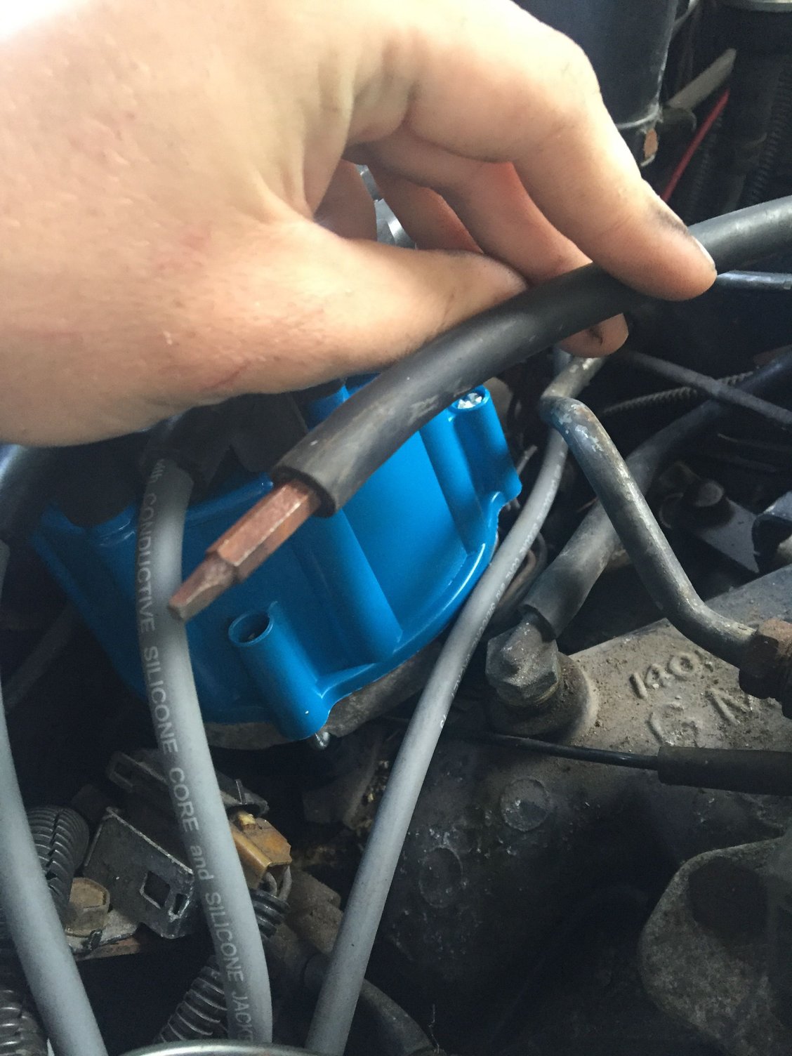

So i did my tune up on my "new" old ride it's not running too bad did a pretty good tune up and deleted the air system but there's still a few unidentifiable parts , so there's what seems to be a vac line right on top of the intake manifold between carb n distrubutor. Pic will be attached it was previously plugged idk what it is or what to do with it , also some sort of T shaped hose from the canister to the carb but not connected , pics will be attached if anyone can just recognize what I'm talkin about n let me know if they can all be plugged or not that'd be great thanks

Several Of Those Hose's Go To The Canister Control Valve,Which I See You No Longer Have.

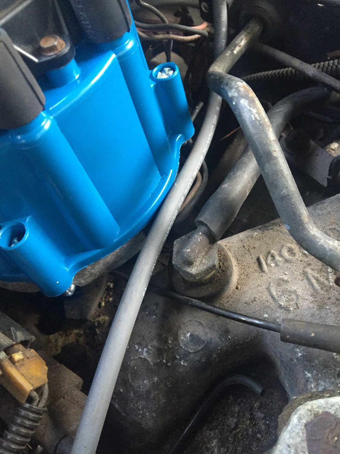

I need to know what that hose is that's threaded into the manifold right in front of the distrubutor last pic

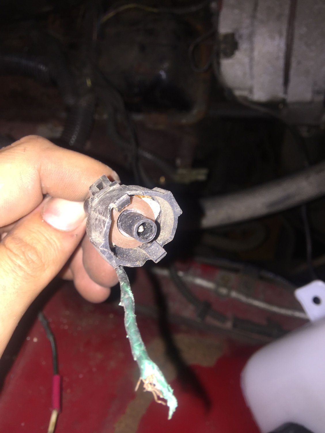

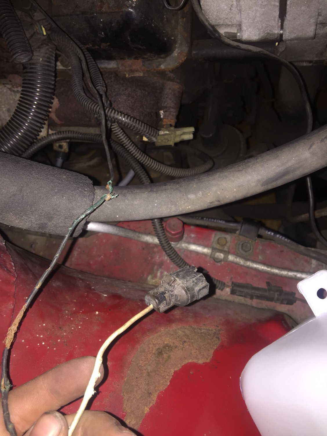

Also found this wire plugged in somewhere under ps header anyone recognize this sensor or wire ?

I think the last pic is the fan switch plug.
It attaches to the switch in the passenger head between 6/8.
Is this a l69 car? The Lg4's I thought had a mechanical fan.
There are some good pics here.
https://www.thirdgen.org/forums/carb...l69-5-0-a.html

that last picture is the fan switch connector. It tells the fan when to turn on.
The Hose you posted a picture of goes to the cannister control valve, the charcoal cannister and PCV valve.
do a search on the site here for vacuum diagrams, that should point you in the right direction.

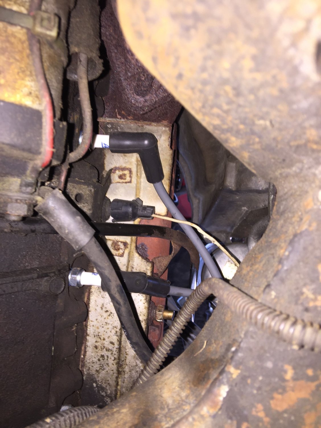

So I just krimped the wire back together can anyone tell me if I got it plugged in the right place in the block. ?? It went right in
Yup. That's it.
