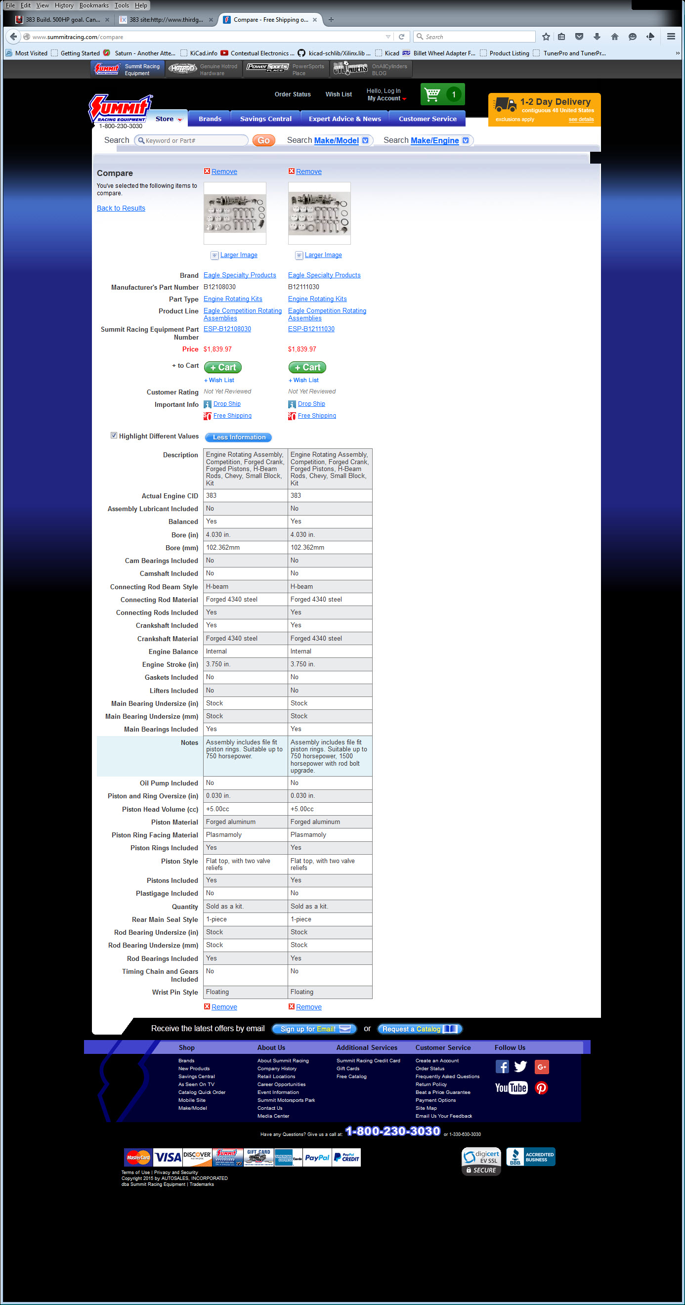

Balanced rotating assembly: 1 of 2 choices.
Common features are 4.030" bore, 4340 forged H-beam rods & crank, forged 5.00cc flat top pistons w/2 valve reliefs, 1 piece RMS and $1839.97. Difference not stated in pic: Part #B12108030 has 5.7" rods (750HP max) and Part #B12111030 has 6.0" rods (1500HP max with rod bolt upgrade).
EDIT: A great link for 6" rods:https://www.thirdgen.org/forums/tech...-w-6-rods.html

I picked that bottom end package from Eagle most especially because it was internally balanced and because it had forged crank, 6" forged rods and forged pistons for $1800. That's just $500 more that the cast version of their balanced rotating assembly.
Maybe the budget stuff you were referring to were the individual cast parts?
I hope so, because if not what you say is truly disturbing about not having received a finished product.
Also how long ago was this?
