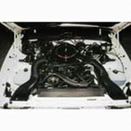

Here's another good mod: Get a 305 HO dual snorkle aircleaner.
I was just reading on the Hot Rod site tonight how they mildly hopped-up an 82 Camaro with an LG4. The dual snorkle aircleaner knocked a full 1/4 second off their ET
GM isn't making them any longer but they show up on the Classifieds board quite regularly.

But seeing as you have a TransAm, I don't know if the aircleaner will fit under your hood

Try a B hanger with those DRs for kicks. It's only five bucks or so from Summit. I've done the secondary metering rod swap (first with a G hanger and AH rods, then with a B and DRs), the AV tension, the dual snorkel and KN filter. Nice mods. Like Sitting Bull, I don't believe the HO snorkel will fit your car.

Why wouldnt it? It is very similar to the one that the lg4 had to start with except it has a hose coming from both sides of the air cleaner.

Didnt the 1984 L-69 Trans Am come with the dual snorkel air cleaner? A while back, my friend used to have an 84 H.O. T/A and i could have swore it had one. Just wondering
Ben
Well, I'm just thinking of how the Firebird's nose is so much pointier than a Camaro's. It is in that area that the funnels fit and I don't know if they would function in that small a space.

In my next generation magazine by year one they list it as coming on camaros and firebirds from 83-87 with the l69.

Guys, I have an 83 TA with the dual snorkel air cleaner and the COOL thing is that you can still use your original lid that takes air in from the hood! I'll post a photo if anybody wants to see it.
From what I've read, the only 3rd gen TA to get the dual snorkel was the 85 HO cars. I've never seen an 85 L69 equipped TA so I can't verify that. I do know that 83 and 84 L69's did not come with the dual snorkel setup.

That is probably because of the cowl.

couldn't you just use that aircleaner and then run the tubing down to make a bottom-feeder ram-air setup?

Colin- yes, you could.
