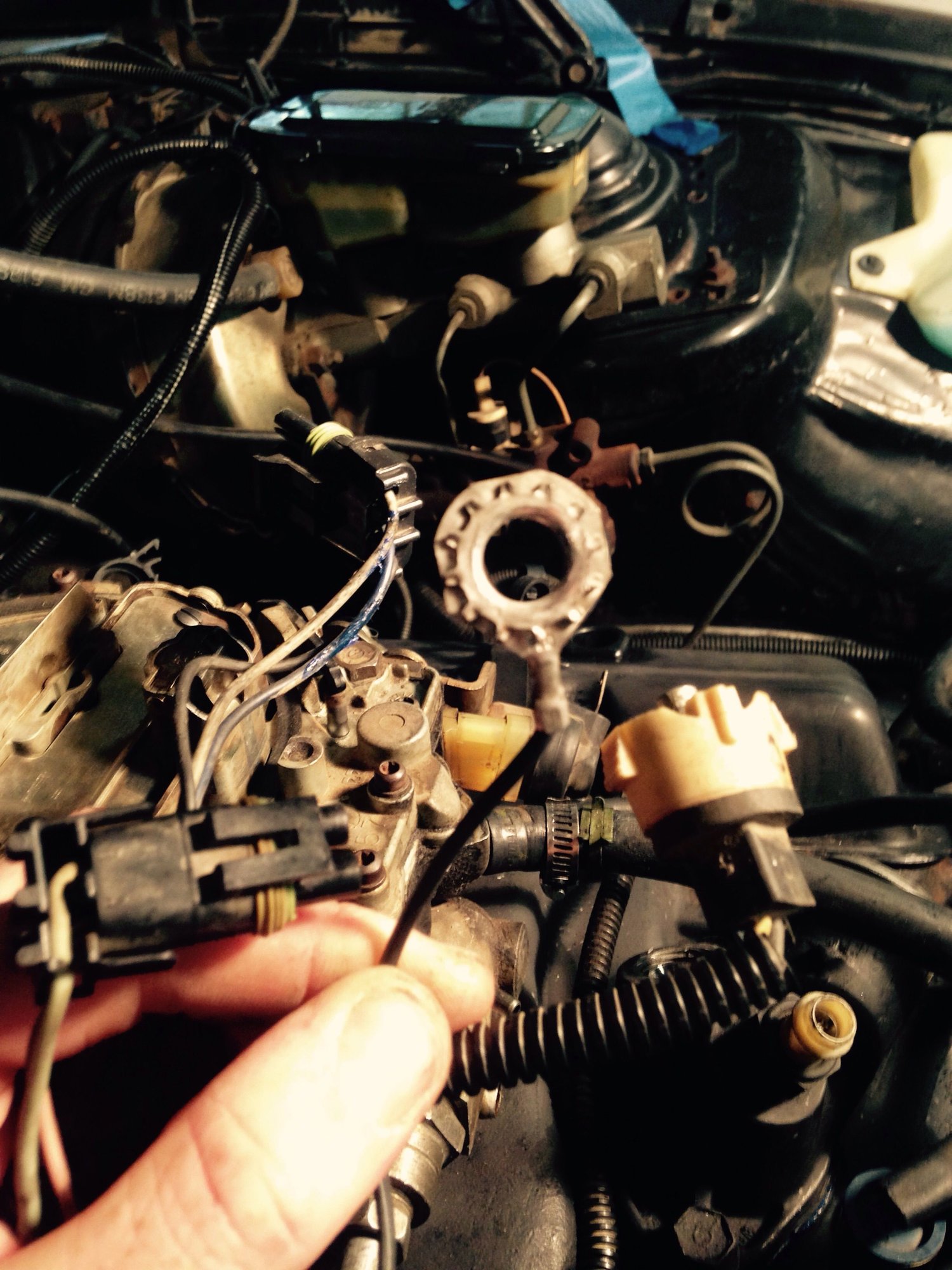

I'm not sure if this wire is a ground or where it goes. Also I would like any tips when installing headers.. The headers are already installed I'm just wondering if there's anything I need to know before starting.

Yes, that's a ground wire. Usually bolts to the end of the head. It would be best to have it attached before running (although it may not affect anything if it isn't).

looks to be the ground wire that goes under the bolt to the top of the alternator bracket up front.
