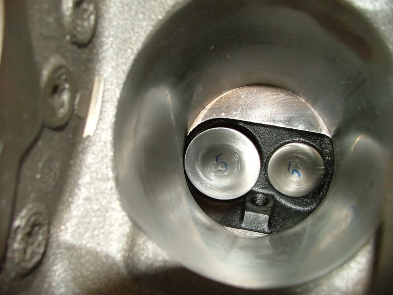

Car: 1983 G20 Chevy
Transmission: 4L60
Re: Newbie 305 build input
For anyone else actually building a 305 out there, this is why it does not need a dual pattern cam and responds best to a single pattern cam. The intake valve is so heavily shrouded by the small bore, especially a 350 1.94 valve head, that the intake valve needs more lift/duration to move the airflow into the engine. Split pattern cams are not really necessary or needed.
Even the engine masters 305 that made 394 HP @ 6,300 with Fastburn heads only ran a 9° split and oh also ran 1.65 rockers. Under 6,000 rpm the duration split would have done very little to help power and would have hurt torque down in the 1,500-3,600rpm range.
Old Jan 1, 2016 | 07:52 PM
  #50
85c1500's Avatar
Joined: Dec 2015
Posts: 28
for those of you including this ding bat that keeps posting on here even when I ask him not to that what to lear why this ding bat is completely wrong about his camshaft thoughts here is some excellent information from a guy who actually designs camshafts for a living. Google his name or screen name and you will find all of the information you need to know about camshafts. Fast355 is the last guy Id take camshaft info from.
http://www.chevelles.com/forums/showthread.php?t=374438
BTW, offset head dowels would do wonders for your intake shrouding issue. But Ill bet you knew that, right?
