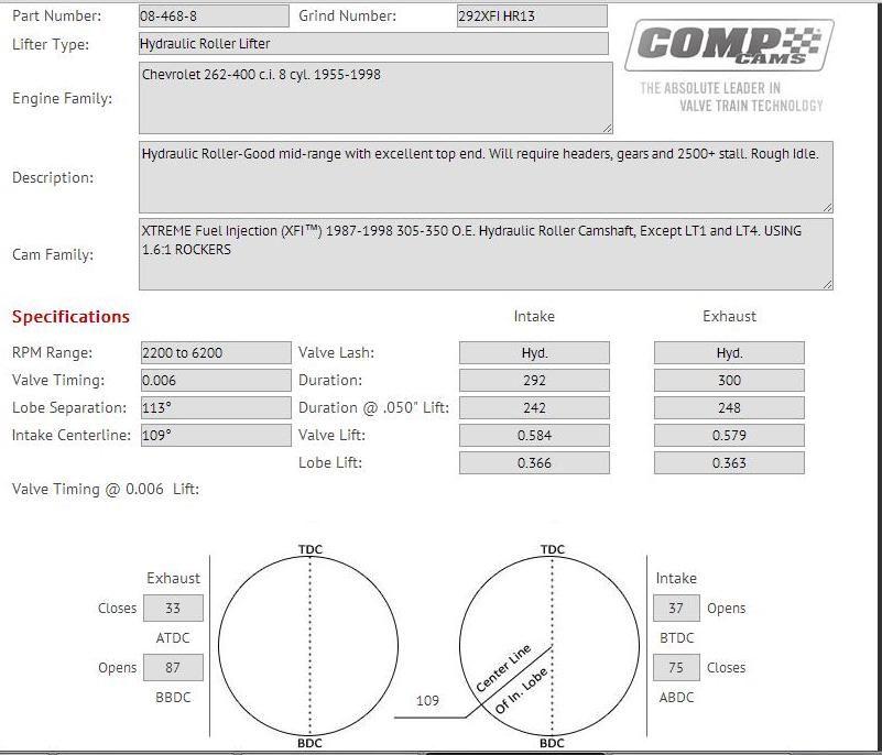

My question to the OP is why? I understand how it happens. I touch off of 7000 rpm now and again but I'm not making any power up there (and I only get there when the limiter is off and I'm being careless).
And byComp Cams reckoning....
..neither will you.
Showing an upper range limit of 6200 rpm and allowing a few hundred rpm for engine overspeed puts you at 6500. I would think that following the spring recommendations (ie. small mass spring assembly like the 26918 specification) you would be OK. Certainly in the valve train stability category. As for a daily existence, like a race only engine that sees nothing but high RPM all the time, it's prudent to be regularly checking all these components anyway.
Edit: Or is this a case of , as LG4Bird suggests, just not a good idea?

Comp's "RPM range" in this case is just plain ridiculous, or it's an error. Even with a 2-plane manifold, come on: look at those duration numbers! They claim their "RPM range" is based on a 350 CID....lol! Even a 383 will want to peak near 6500 with it.
OR.......maybe it's their roundabout way of saying it's safe (valvetrain stability-wise) with their recommended springs up to only 6200 rpm. Whether they intend that as their hidden message or not, that's about the truth of it.
People have run it successfully to 6500 rpm, but not with those 918 springs. I'd want 150 lb on the seat with a beehive and at least 160 with a dual spring.

Yeah, that thing is really gonna want to rev. It'll pull well from 6200 to ~7000. Get in touch with Lloyd Elliott www.elliottsportworks.com and get a proper cam for it.
If I were stuck choosing from among Comp's cams, I'd rather go with the XR294.
You know I thought the same thing and have before looking at some of Comps dyno graphs. Interesting thing about that 292XFI though is that it actually has less overlap than the XR288HR. Looking at simulations of the two of them with the same compression and cylinder heads, they both peak around 6200. Of course different heads and intake will move those peak numbers around but the wide LSA of that 292 takes a lot of the bite out of it.
Yeah, I'll give you that; the XFI cams' "wrong for SBC" 113 LSA does result in a bit less overlap than more properly spec'd cams would give.
Nevertheless...peaking at 6200 rpm would mean shifting about 6700 rpm with most trans ratios if you're interested in optimizing your use of the powerband.
Ult, overlap doesn't relieve cylinder pressure. Later IVC event does that.
