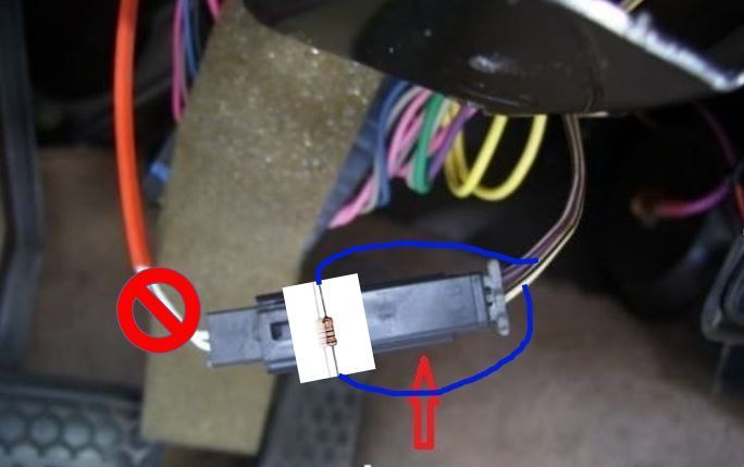

In this photo it shows the connection. The wires coming from the column are in the orange casing. You do not use those.
The wires coming out of the column connect to two wires that come from the nest of wires in that area. You put the resister/resisters between those wires.
I do not know if your wires are the same color as what you see here.
If you still have the stock connecter you can make a loop with the resister and plug the ends into the connecter.

Follow Ron U.S.M.C.'s directions, but I don't think that last picture with the resistor is labelled correctly, so follow what he says:
"If you still have the stock connector you can make a loop with the resister and plug the ends into the connector."
not what that last picture shows. The resistor should connect together the two pins in the IP harness side connector, it should not connect to both the ignition lock cylinder connector and the VATS module connector, it wouldn't work that way.

The wire labeled "ignition" is just a continuous line to vats with the resister placed in the middle.
Ignition and "key cylinder" are two different things.
Its to give you an idea as to what we are trying to accomplish.
The second photo is just for reference.
= "If you still have the stock connecter you can make a loop with the resister and plug the ends into the connecter."=
I hope that cleared things up a little.

Lysh, we understand that part of it, but you don't need to buy anymore than a $3 pack of resistors.
Determine the key resistance, buy the right resistor, and connect the two wires together using the resistor. Install the resistor where the dash harness plugs into the steering column harness. It won't matter what steering column you have, because you didn't change the dash harness. The resistor replaces everything VATS related that was in your original column. You had to have unplugged this connector when you took the original column out. That's where the resistor goes. Just like in Ron U.S.M.C.'s picture. The two white wires come from the column, the violet/white, and white/black wires are part of the dash harness.
I'll try to show you, using Ron's pictures, that this is all you have to do and is so much simpler and much much much much cheaper to do.

If I'm seeing this correctly you could take the 2 white wires where the circle with line thru it, cut it a the end of the orange wire loom. solder 1 wire to 1 end of resister the other wire to other end of resister
then you would have a antitheft device cause you could unclip the connector when parked them plug in when ready to leave correct?
Yes, that is correct. Because the key used to do the same thing; when you took your key you took the resistor as well.
