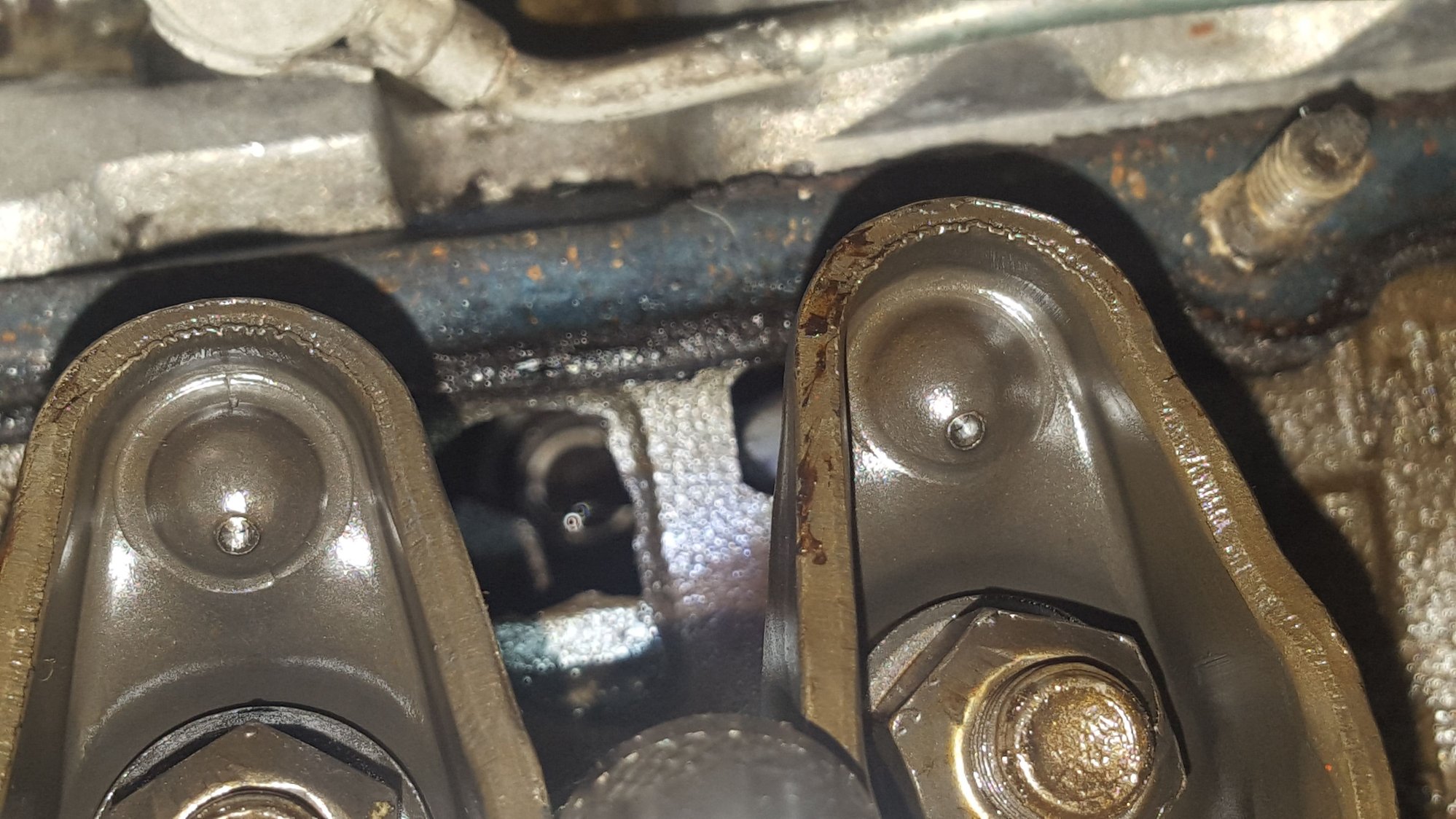

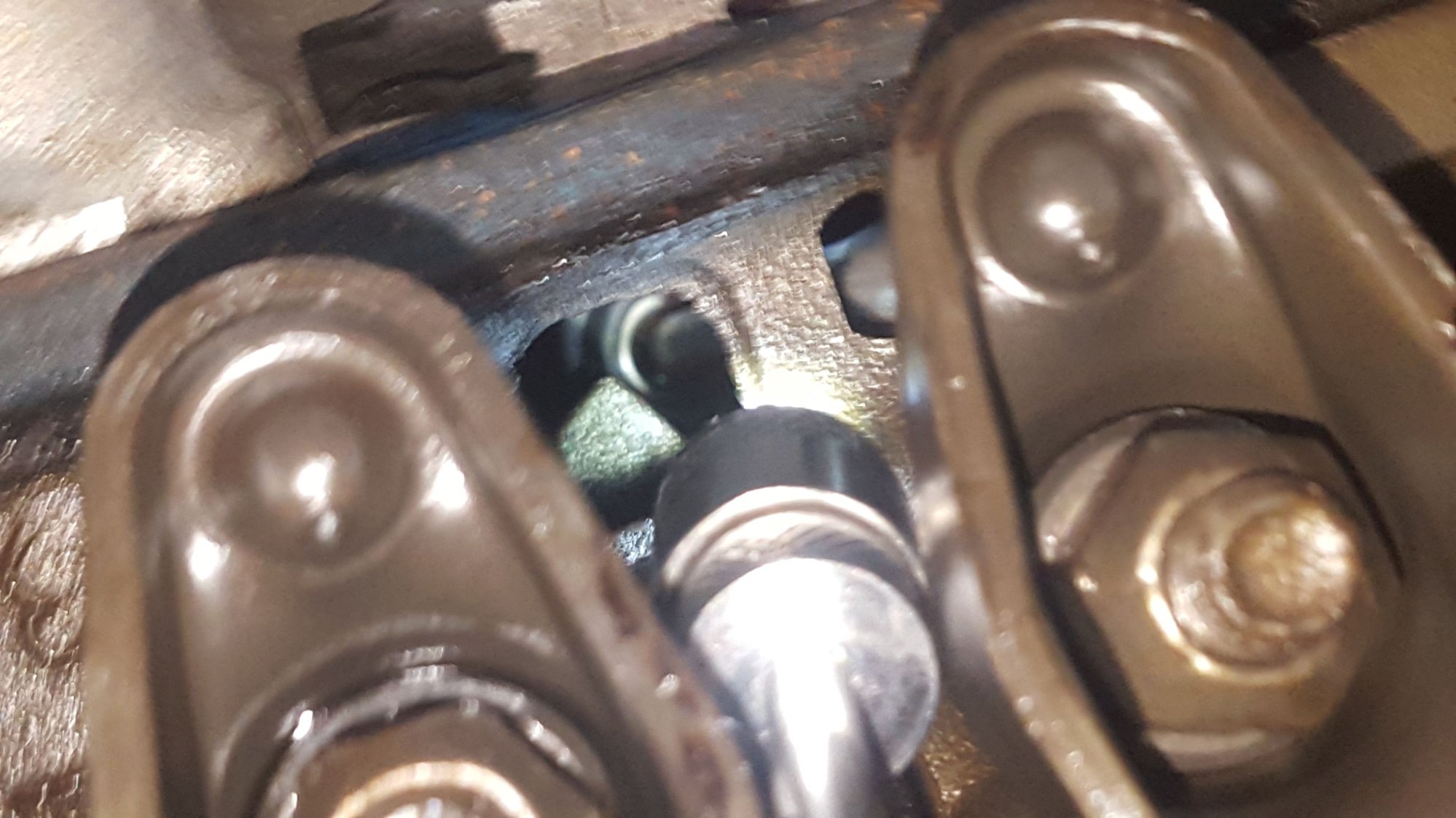

Car: 1986 Iroc-z Camaro
Transmission: 700r4 Automatic
Re: White smoke from exhaust vid link

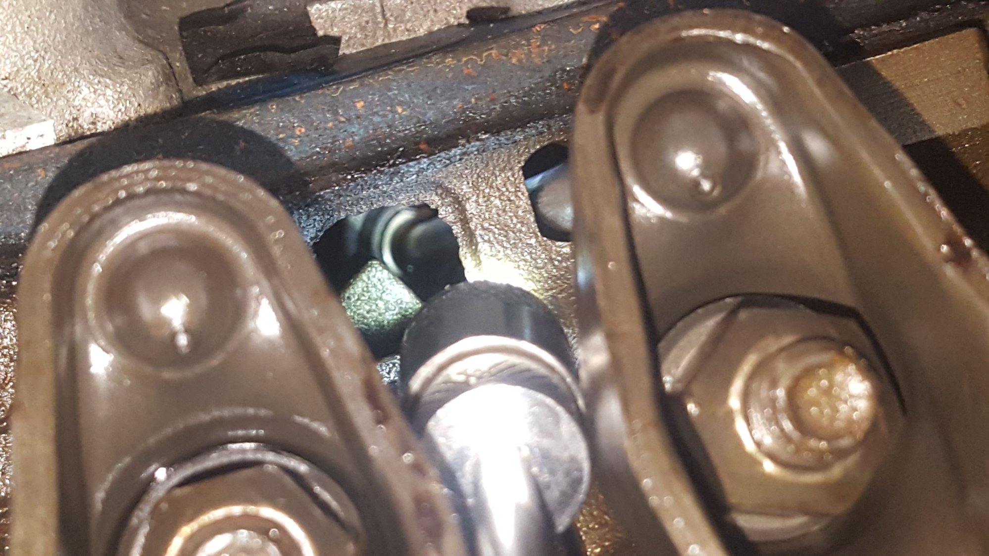

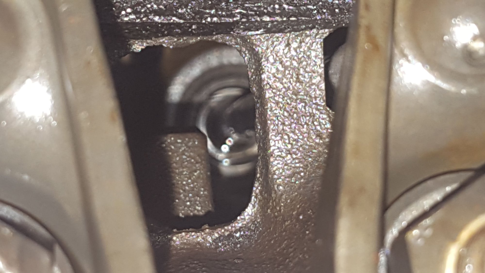

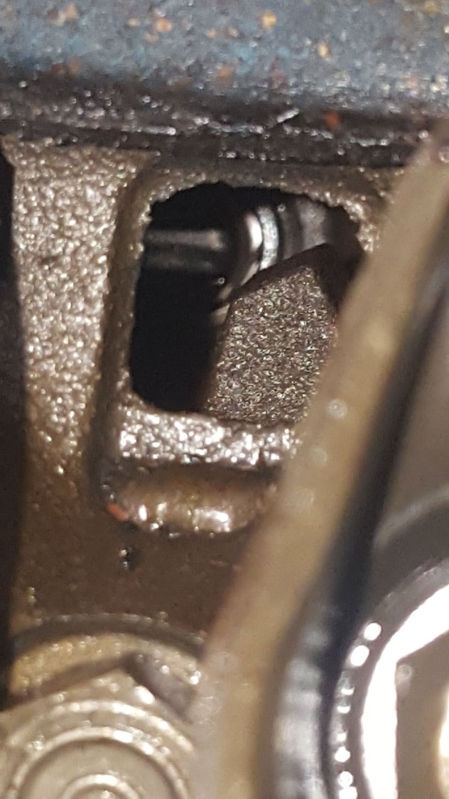

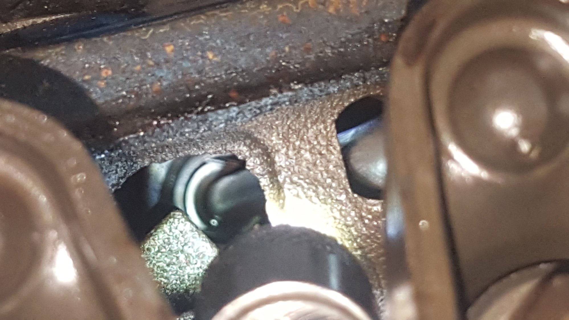

Pulled off the drivers side valve cover.
These are the only camera shots I have.
I can't really see any issues from my point of view.

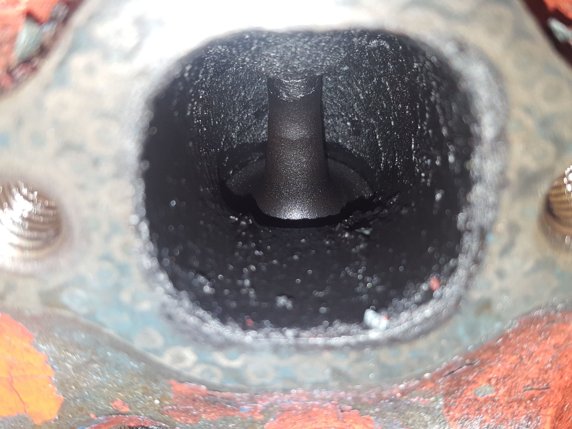

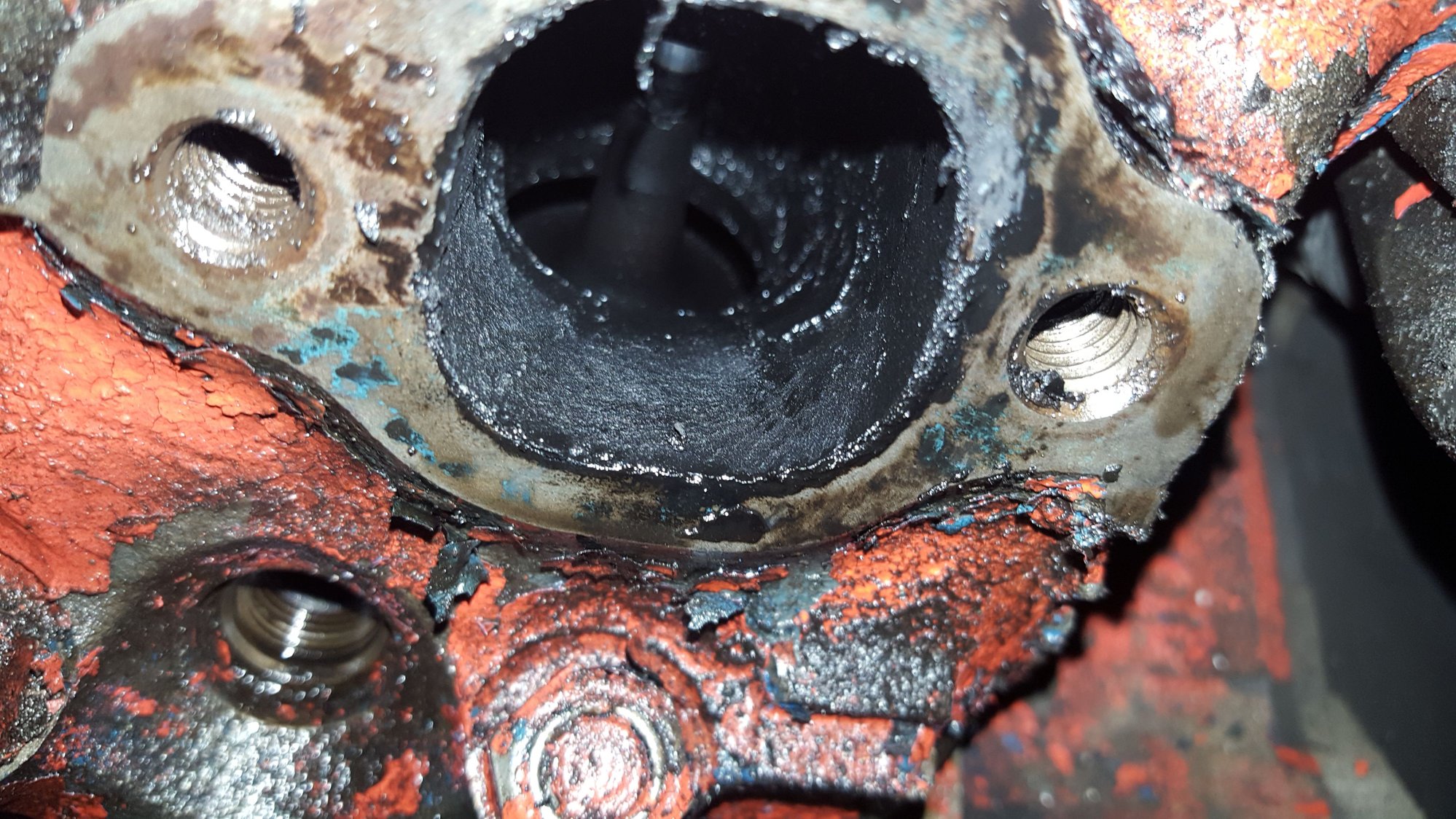

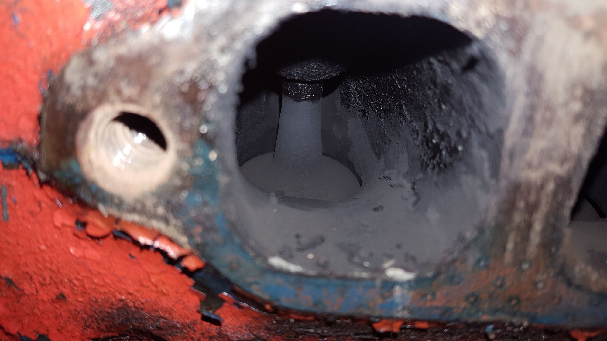

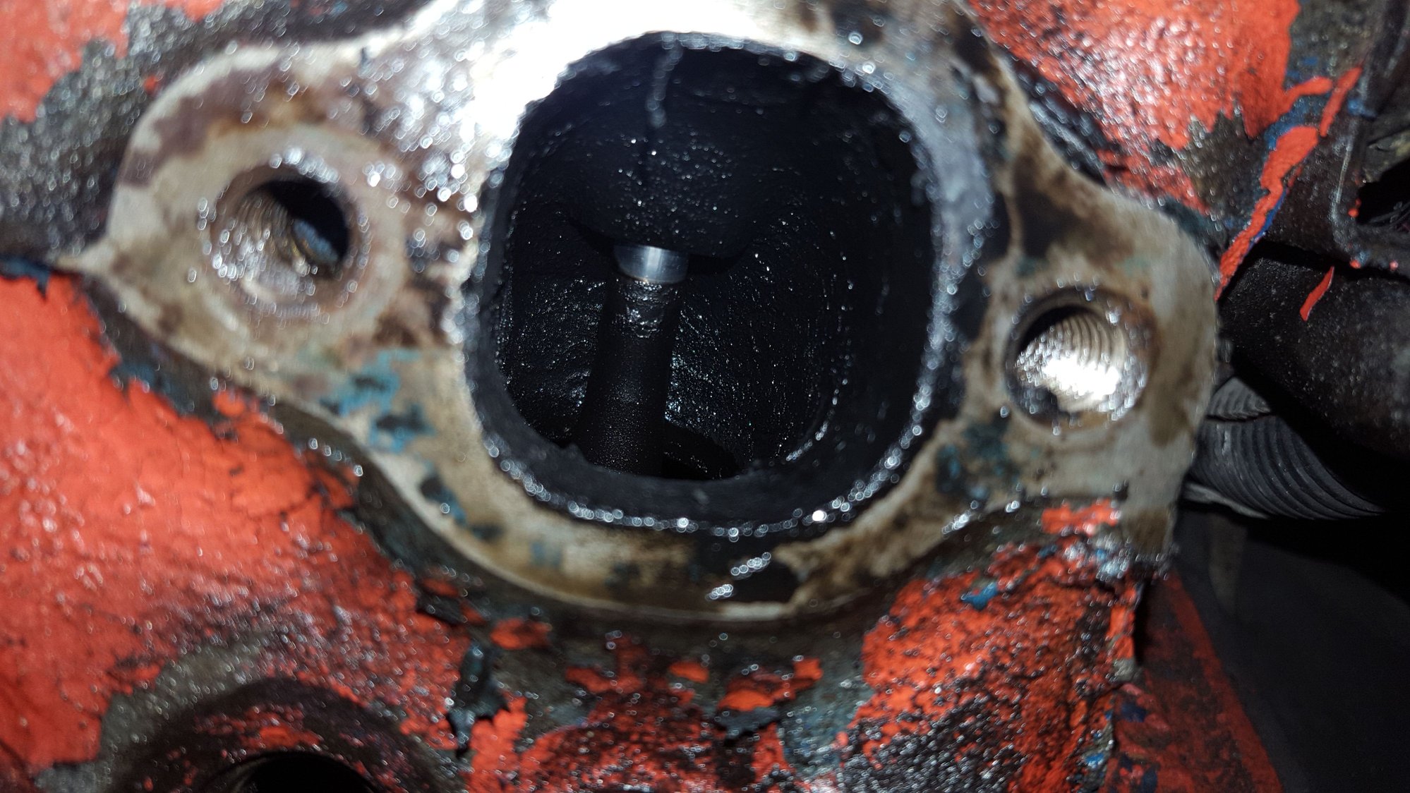

Cyl 1 exhaust port
Cyl 1 exhaust port
Cyl 3 exhaust port

Cyl 3 and 5 exhaust ports

Cyl 7 exhaust port
Cyl 7 exhaust port
Cyl 7 exhaust port

Can i clean these out with brake cleaner?
Cylinders 3 and 7 spark plugs were both fuel fouled

Are those darker ports wet? Looks like you are getting oil in your exhaust ports. I would also try to get that 3 year old gas out and get some fresh gas into it. Replace all the plugs and see what they look like when you run the motor again.

Yeah they are wet with what i can only assume to be oil. The old pcv valve was clogged and disgusting so i replaced it. Drained the old fuel out and changed the fuel filter put 3.5 gallons of new fuel in. I just got new spark plugs. When i put the new headers on I'll put the new plugs in and double check the wires.

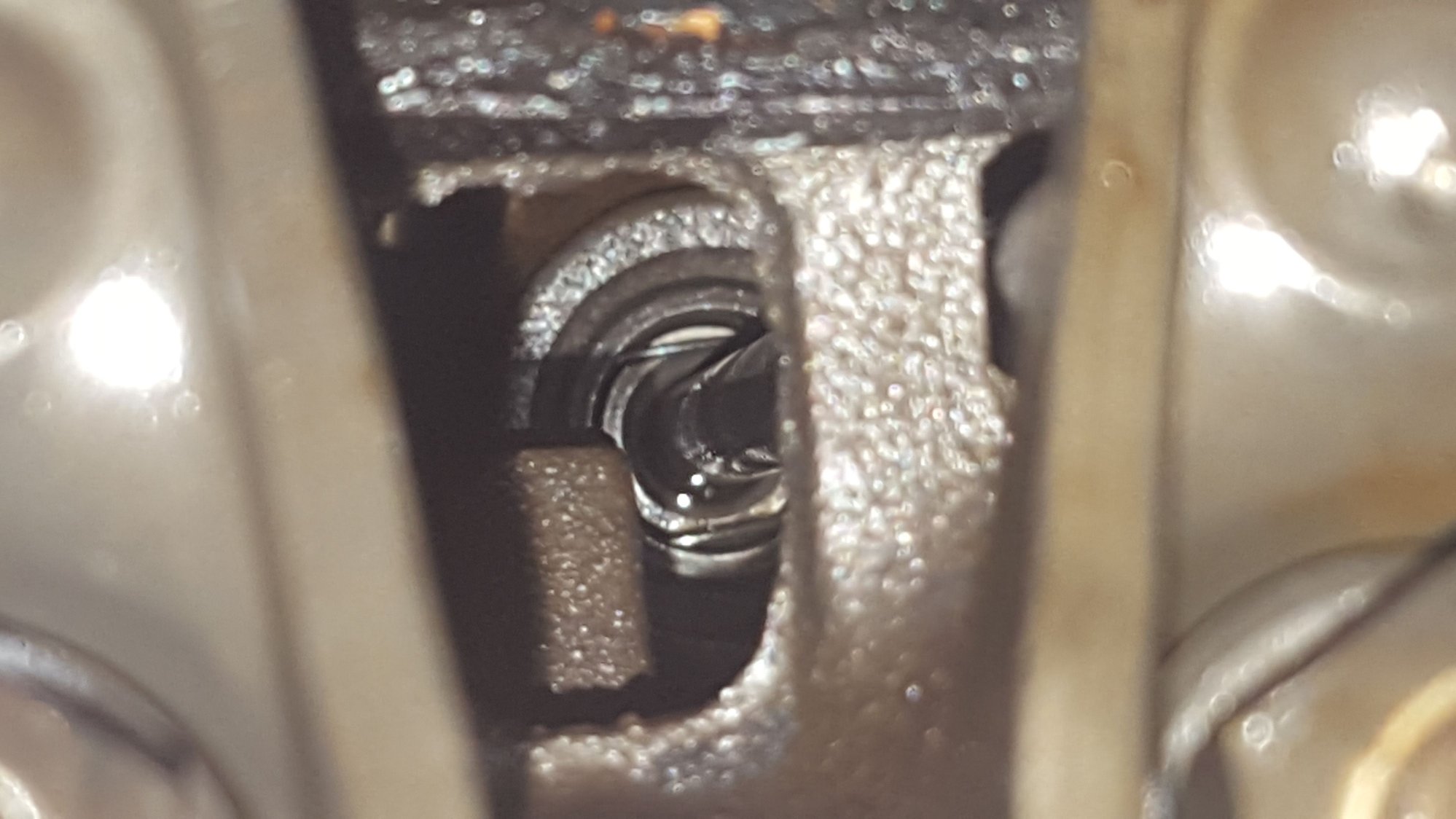

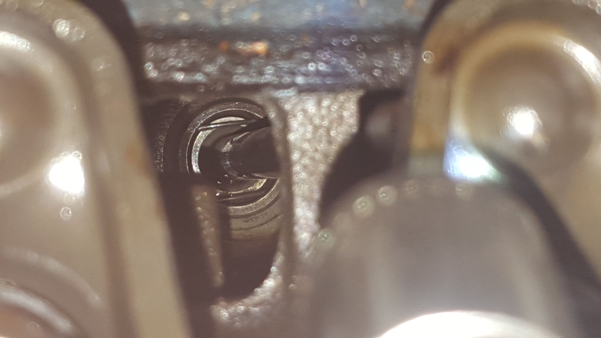

Cyl 2 exhaust port
Cyl 2 exhaust port
Cyl 4 exhaust port
Cyl 6 exhaust port

Cyl 8 exhaust port
Cyl 8 exhaust port

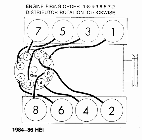

Rough idle issue:
This is how the firing order should be.
This firing order is the only way the car will start.
Why is it like this and how/should i fix it?
