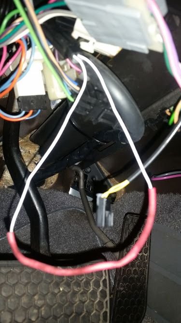

Okay... read up on all the stories on the vats resistor bypass. I did it and it worked great. Mine was #7 1.87
I stopped by radio shack and got the assortment pack then soldered in series and heat shrinked the two resistors I needed. Instead of cutting my wires I got some plugs from a local junkyard so I just have a empty plug hanging now. In case someone in the future wants to hook it back up they can.
I did run into a strange problem. All the posts I've read on this showed two white wire in a orange sleeve. I looked at 3 junkyard cars that also had it this way. Mine was different... it had 2 orange wires(at least I think they are orange... I'm colorblind) in a black sleeve. I plugged my new resistor plug in and it now works fine. Security light comes on and goes off like its supposed to.
