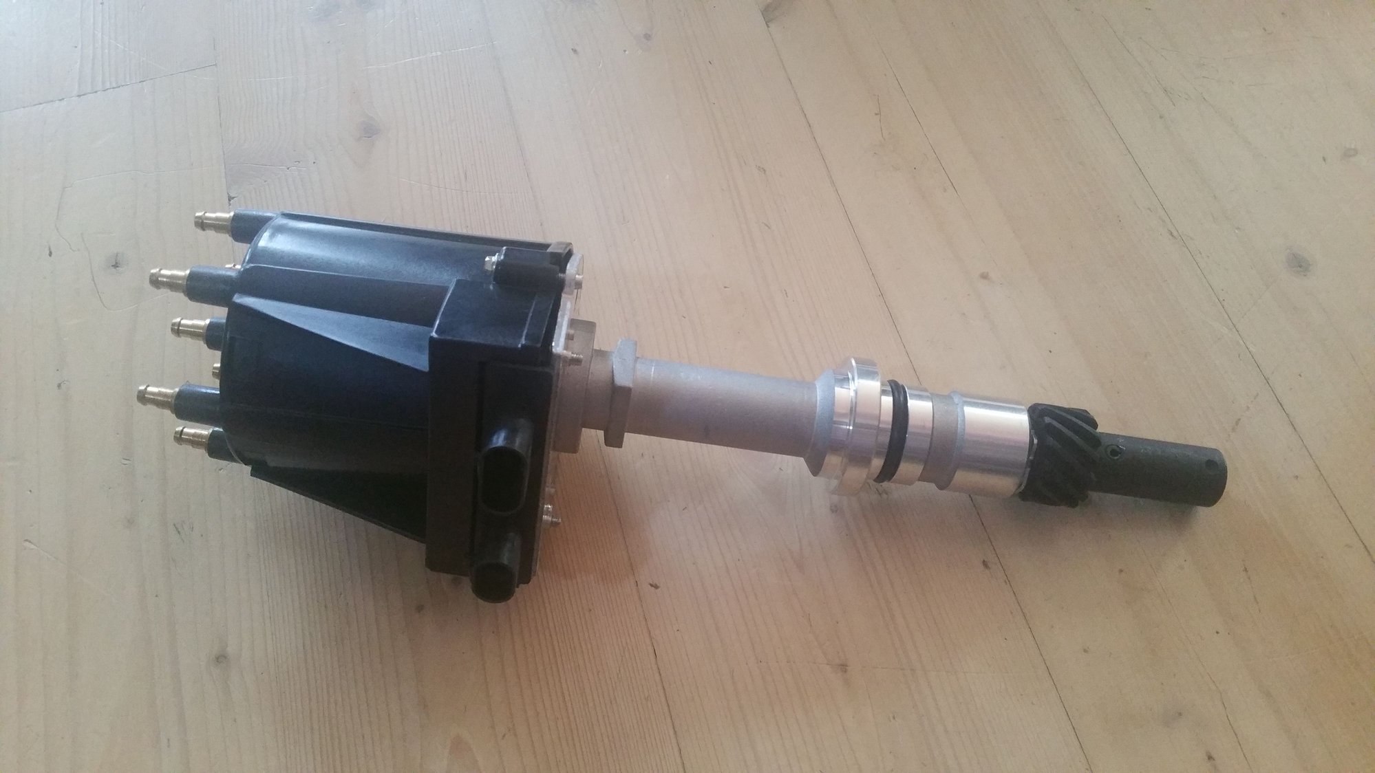

This is how it began! So i checked if my engine was giving any spark. I saw that no spark was given (i just took one of the spark plugs and put it on my engine and cold-started it). Nothing, no spark. So then i thought that maybe the ignition coil has gone bad or the distributor. After that i bought a new dizzy.
Placed the new dizzy and DARN, nothing. Still the same, engine wont start. Okay so then i thought that obviously the ignition coil is the problem. Thanks to my friend i could test my ignition coil with his one to see if mine is bad. Nothing, no spark still. OOOOOH you know what i discovered then? THE ROTOR IS NOT MOVING. Yeah great, now i knew that the problem is not an electrical part, but a mechanical one, since a rotor must move because the camshaft turns the rotor, obviously now i was really sad, because this meant that the valves and camshaft might be bent.
