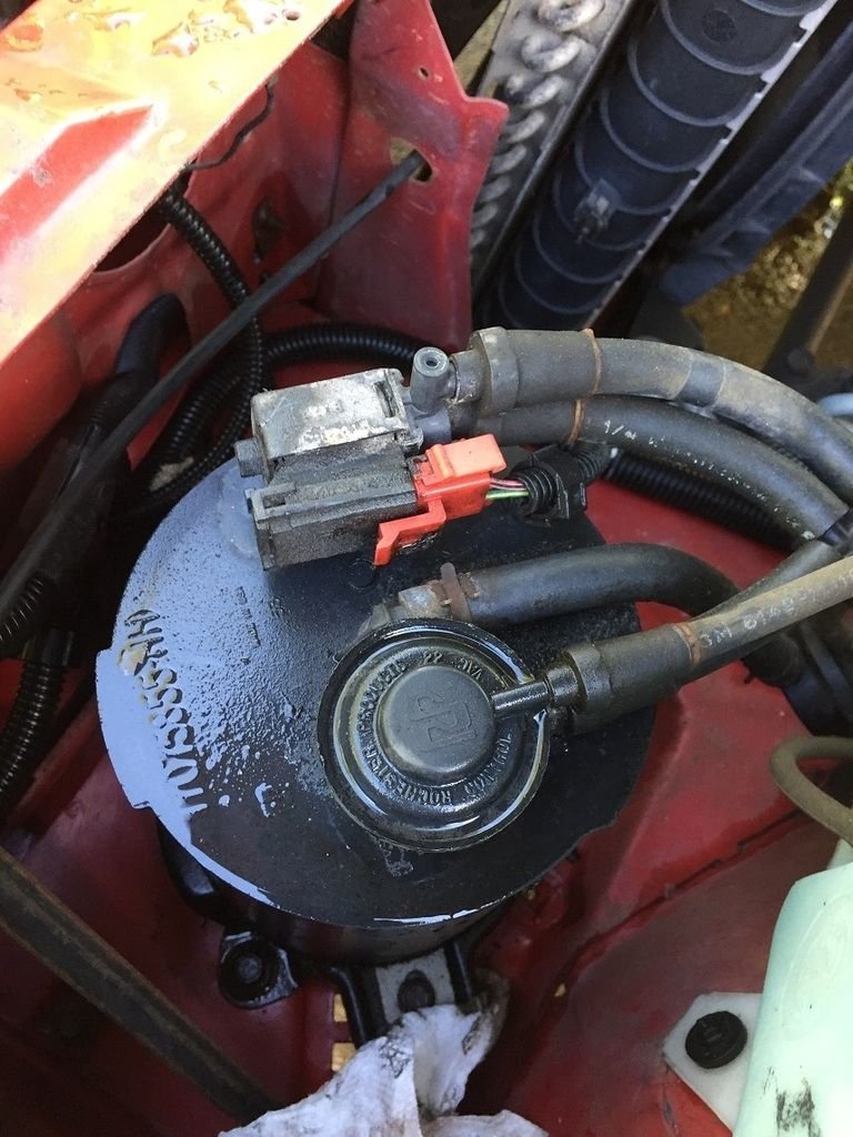

My best guess is the charcoal cannister, but I cannot find a nipple/connector on the cannister that is clearly missing a line.
Could the nipple have snapped-off clean on the top side of that multi-connector on top of the cannister?
I was doing some spot-cleaning on the engine bay this afternoon when I spotted the orphan hose.

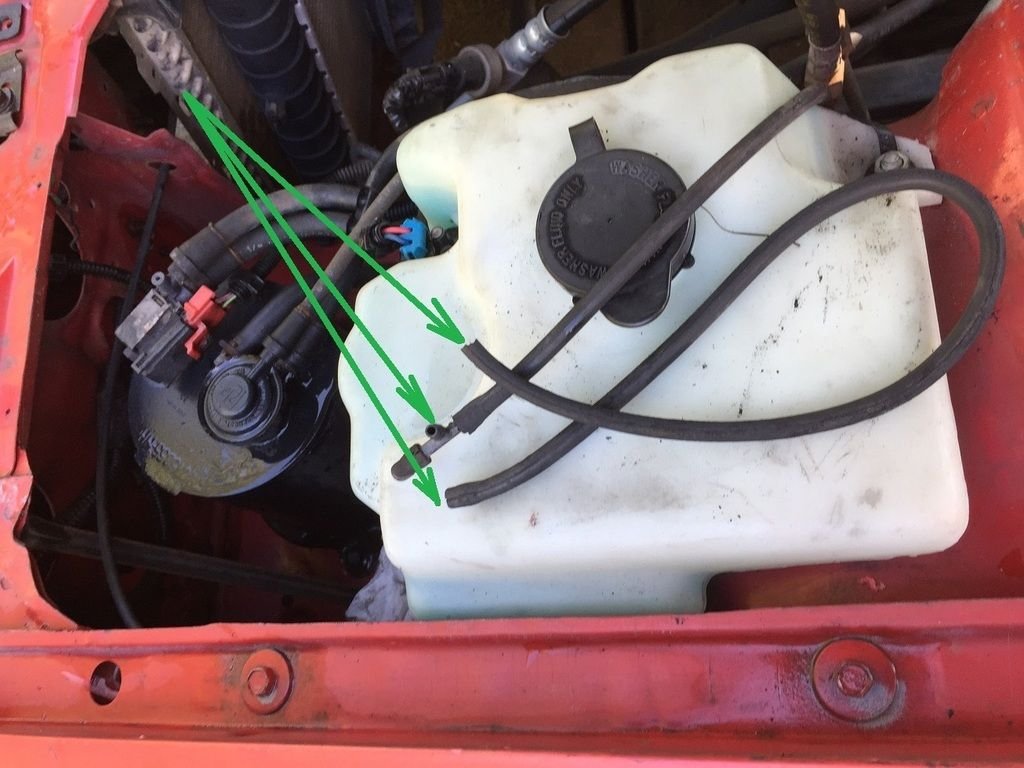

Its obvious that the orphan hose used to be connected at one end to the two-way connector shown in the pic. But where does the other end go? The other end of the hose looks mightily degraded, and probably hasn't been properly connected to anything in a long time.
Help and suggestions would be much appreciated.
Orphan hose:
(the left arrow points to the end of the hose that was recently connected to the two-way multi-connector --- the middle arrow is the nipple that the orphan used to be connected to --- the right arrow is the mystery-end of the hose that I'm trying to figure out where it used to go)
This pic shows the source for the hose that leads to the two-way connector that the orphan had been connected to:
Ye olde charcoal cannister:

The "source" in your second photo is for the HVAC system.
Your orphan hose most likely goes to the vacuum reservoir that's located under the charcoal canister (you'll have to look up from under the car to see it. The reservoir looks like a small cannonball).
It appears your car does not have cruise control, no?

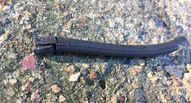

...and the last vestige of vacuum hose that was attached to the nipple.
It fell to the ground when I touched it like a reptilian fossil being dislodged from a cliff-face by a wandering child.
