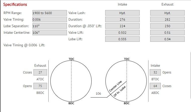

So we're putting together, on paper, an engine build for our L83 SBC 350.
It's going to be a weekend driver. Pretty much solely street use.
Stock bottom end.
Heads: http://www.ebay.com/itm/SBC-CHEVY-35...JRLSq1&vxp=mtr
Cam: http://howardscams.com/i-24079060-ho...ifter-kit.html
Intake: Edelbrock Performer RPM
Carb: Holley 670-700CFM something
Exhaust: Hedman(Or better if I find a used set when I have the money) headers, wrapped.
What do you guys think?

With flat tops and 64cc combustion chambers, won't that be a fairly high compression? I was guessing 10.1:1+ and someone said he would guess it could be as high as 10.3:1
I was recommended the cam, and looked over the specs. It is a little bigger then most people recommend, but sounds like it will give plenty of low end for street tires.
One reason for the bigger cam is that we want a lopey idle. This is just going to be a weekend fun driver, so I like the idea of it. To me they sound great if they're not stupid rough.
I know you can't trust what you read, but White machine shop that sells them, says that they do put high quality springs. I believe I heard somewhere they use competition product parts. And at $161,(that's right off of ebay so I bet they get them cheaper) for a bare head(out of stock), they could easily use quality parts and turn a large enough profit.
We plan on dissembling them on arrival and doing a small port job with a die grinder.

Holly mole just looked at the specs on that cam. 238/240@.500 .531 lift on a 107 LSA mechanical flat tappet. That is a monster of a cam, for short track cars.
I would look at one of summits hydraulic flat tappets save some money to put into the heads. Just my opinion.

I would reconsider the parts selection. Seems 238/240 like a lot of cam for a 350. What gears does your car have? I would want 4.10 at least. I would ask Howard's what cam they suggest for your set up. I would ask whites the same question.
I have a 230/236 in the 400 in my vette.
I think an Isky 270/270 Mega Cam would be a better choice for a weekend car with a 350.
As for the heads, I would save my money and buy something else. Heads are the most important part of making hp. If you buy those heads I would have a trusted shop check them very carefully. Personally, I rather wait and buy proven quality heads.

http://howardscams.com/if-5950-howar...mendation.html

Not so bad depends on those advertised vs .050" numbers being right? I can't say I've seen any cam profile with lobes that fast. Regardless of the lifter type. Maybe I'm wrong. There's something to be said when measuring mechanical lifter cams.
Duration at 050 Intake: 238
Duration at 050 Exhaust: 240
Duration Intake: 266
Duration Exhaust: 268
A cam card would be ideal. Time to download another Howard's catalogue.
You're right about the comparison to the Thump'r. But this grind looks like circle track stuff.
If that advertised number is right and the intake valve closing is a 55 degrees (IIRC), that'll build a lot of cylinder pressure as the cam behaves short. But the .050" number is high by comparison with plenty of overlap. There's the vacuum deal as pointed out.
Not sure how to take those cam specs.
I just noticed this on hoards website. Might explain a bit

Re: Opinions on this engine build?
Should I ask the Howard's cam guy anything or can anything of use be found on the interwebs?
I went the mechincal as I was told by numerous people that it allows for higher lift while keeping the duration down a bit. No where near a roller, but slightly better.
And all around besides needing to adjust stuff a few times year, they're more reliable.
And as for vacuum, we're either going to go with a canister or manual brakes.

If you are talking to Howard's again, ask about the advertised vs .050" duration numbers.
Even with a mechanical flat tappet and taking into account the valve lash, I can't see how they get from 266 advertised to 238 @ .050" . A hydraulic roller, and this is Comps quickest XFI lobe, will get you from 274(adv.) to 224 (@.050"). I can't say I've seen any quicker than that. (I'm obviously missing something here...)
Old Oct 14, 2016 | 09:17 AM
I looked around a bit after realizing it was a sprint car camshaft for track racing and number like that are common. Now why howards would recommend it for street use I have no idea.
http://www.speedwaymotors.com/Speedw...300,98991.html
http://www.speedwaymotors.com/Speedw...RPM,24716.html
Haven't been to that part of the catalogue.
It'll be interesting to see the idle vacuum numbers.
I believe the reason they have the super fast ramp rates is because most sprint classes have fairly low max lift regulations so they have to ramp faster to a lower max. Although could be wrong. I would definitively talk to howards about what valve spring to use.

It's all in how the solids are measured. Different lifter rise for the advertised duration will result in a smaller number. Say, .020" as compared to .006"-.008" typically used for hydraulics.
The DCR calculators, using the cam card advertised numbers, don't take that into account. The low advertised number fools the calculator into thinking the cam is very short. This engine will need compression.

So, all in all, is it a..
Def don't.
I wouldn't.
It's fine.
It's good.
It's great!
I did do some research about it being a camshaft designed for a sprinter car but how does that make it bad for a street car? It's not one that anyone gets, seems like it's almost never been mentioned on any forums before. But is that because it's unknown or because it WILL NOT work good in a street car?

Originally Posted by midias
As I said before you really seem dead set on getting this combo so just do it already.
I got one forum that after 8 pages got this build and all agree on it, and howards cams that agrees with it, and I got here where everyone seems to think it's a stupid fart can build that built completely for sound and is going to be a piece of trash on the street.
I get that it's different and that people like to say it's bad, but what are the reasons? Just because it says it's for a sprint car or because it just wont work with a street car??
We won't have power brakes so vacuum wont be an issue.
Think of how a sprint car runs....then think of street car driving. Will you be doing sprint car runs on the street? Lol
Its alot of duration and a very tight lsa. Its gonna have high overlap and be lazy in alot of the lower end rpms. It might even buck at cruise
A better cam would be something on a 108-110 lsa imo and maybe tiny bit less duration. It will make for a wider powerband and better torque curve
At this point I just want to see him do it, I have developed a morbid curiosity but don't want to spend the money out of pocket. I bet with those ramp rates the valve train makes some good noise. The springs better be well matched and probably not w/e skip installs. I know the patriot heads I ran the cheap springs they came with and they sucked for my XE274 and I ended up installing some new PBM springs.
