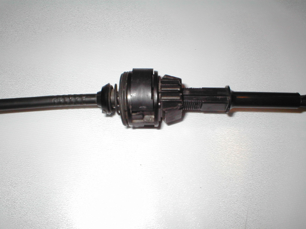

Photos 3-7 are of an actual park lock cable, removed from the vehicle for clarity.
Here we see the park lock cable in it's typical installed state. Not the fixed plastic tube over the cable is not broken. The adjustment lock is in the locked position. Note the teeth on the side that would normally be facing the firewall, and the tension spring.
Note here that the plastic tube is retained in an adjustable assembly that clips into the shifter assembly. Again the adjustment lock is in the locked position.
Here we see the same view as before, but with the adjustment lock moved to the unlocked position.
Now we see the adjustment lock moved up to the unlocked position, and the cable adjusted all the way toward the firewall. Note the spring is visibly extended.
Here we see the cable adjusted all the way towards the shifter assembly, the spring compressed, and the adjustment lock pushed back down to the locked position.
Follow the instructions from the manual to adjust the cable. Considering that your park lock cable is broken, you may have to replace it to complete the adjustment process.

Well Drew thats exactly what i needed, i had no idea the lock cable had that adjuster part that lifts upwards like that.
The cable itself isnt broken its just part of the black sleeve that snapped off but doesnt actually affect anything.
Anyway i lifted the adjusted and it extended all the way out, and the keys came straight out then i put it back where it was a bit tighter but the keys still release freely. Result !
