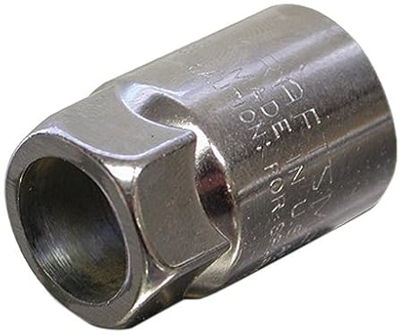

I found and bought the cut down spark plug tool. It's $30 but advertised as specifically for FBody.
SLP 30102 Spark Plug Socket
Amazon Amazon
Also, I think the NGKs are short plugs. At least they look short.
SLP 30102 Spark Plug Socket https://www.amazon.com/dp/B00CE2L7ZE..._6PQVybX099ZCV
SLP's special spark plug socket is just a Craftsman spark plug socket with the 3/8" square drive hole drilled out, and about an inch of length cut off. A pawnshop Craftsman socket can be modded the same way for a lot less money.

Yep. Turns out the SLP socket is waaaay overpriced. You can cut down a spark plug socket as long as you have a flat ratcheting wrench to drive it.
If I didn't have the ratchet ability, the handle stroke is so short for some plugs,it would have added 30 minutes and lots of frustration. Literally more than one plug was, move the handle, back one click, handle, back one click. ONE CLICK. But I could just keep going. Imagine turning, lifting wrench, moving wrench, lowering wrench, repeat 1,000 times.

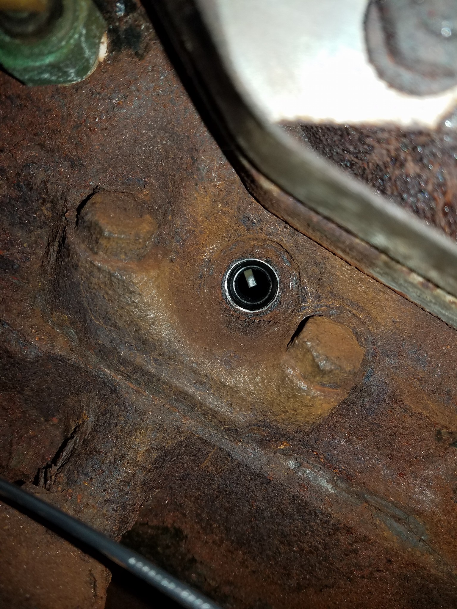

Worst case scenerio happened to me with the #3 last week. Can't extract it.. going to use it as a good time to refresh both heads.

Dang! That sucks.
Ive seen frames rust out on cars before seeing that much rust on the motor!
Do you live close to the ocean or something?

That is a super pic!

Car came from Jersey, had a couple winters driven, but not many. Certain areas on the car are perfect, some are "ok", and others are bad. The floors are good, though..
Heads come off and go to the machine shop next week for a full refresh. Motor mounts are being done at the same time.
Not a cheap mistake, but the car will be better for it I guess.
