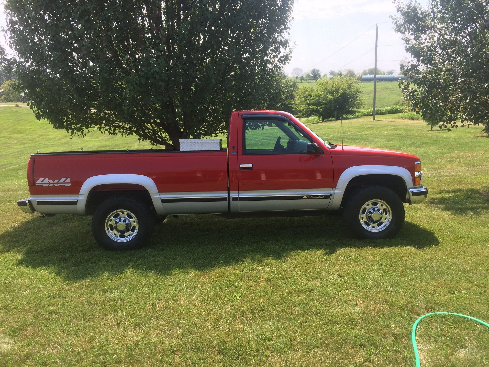

If I remember correctly the 350 tbi in my truck is the last of GM's flat tappet cam engines. It's a 1995, they went to vortec's in 96.
Pushing 186,000 miles, 10W-30 Quaker state Defy has been the oil for the last . . . .10 years? That's getting harder to find though so I'm going to have to swap to pennzoil high mileage (which I use in my current 4.0 litre Jeep @ 150,000 miles AND my previous 4.0 litre jeep that was at 265,000 miles before I sold it - still running like new).

Nice truck. My 95 does not look like that anymore.
[/QUOTE]
thanks!
