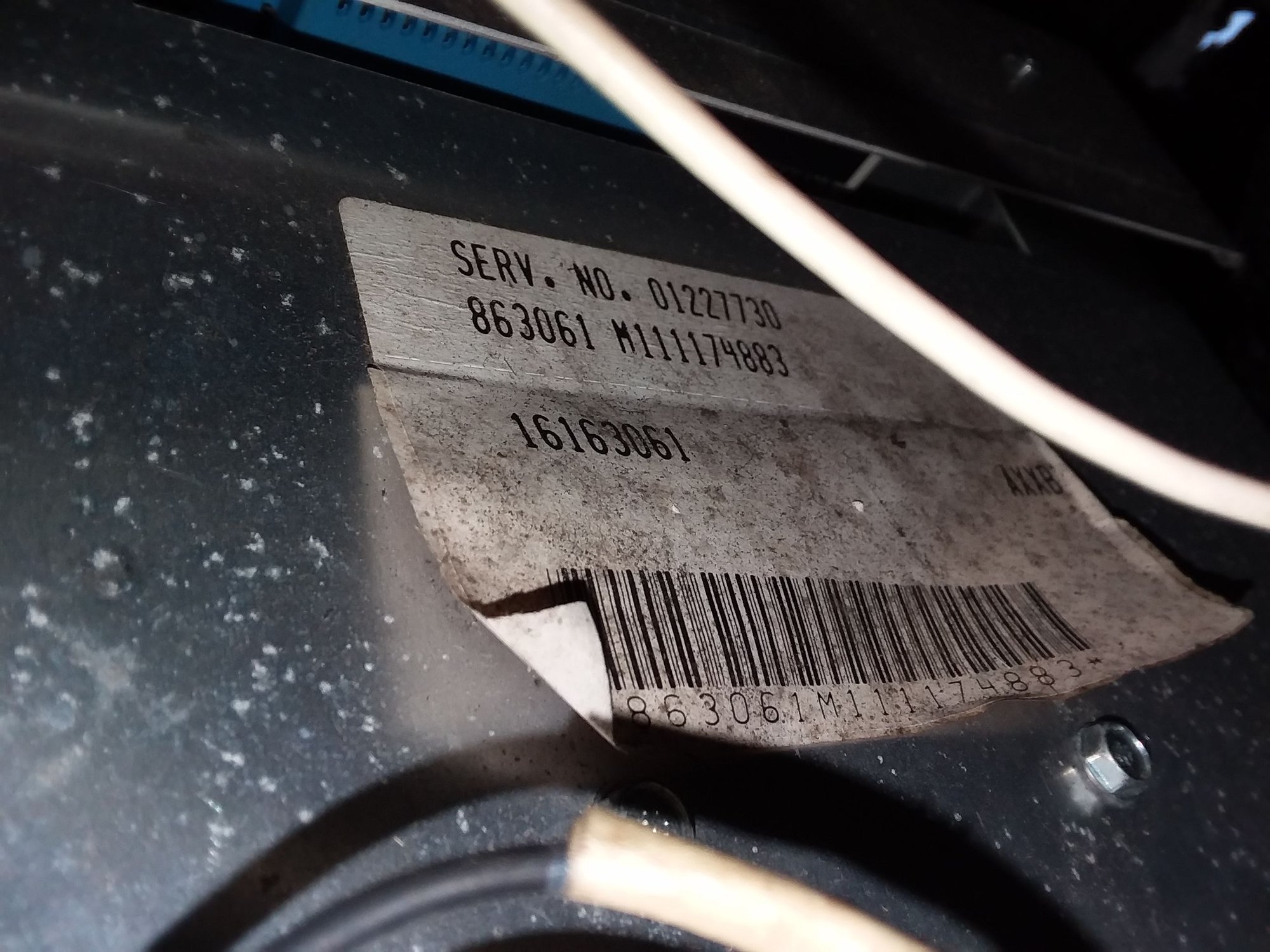

Can you pull the computer out of the dash and determine if it's a MAF, MAP, or other ECM?
If you know which ECM you're running it might help narrow down which sensors should be used. After that, there's the chip in the computer, and how it's programmed. If the cam or other parts aren't fairly close to the engine that the computer is tuned to run, it might not run right at all, even if the correct sensors and wiring are used.

Re: 89 firebird map sensor wiring??
1227165 tpi maf 86-89
1227730 tpi sd 90-92
1227727 tpi sd 90-91 corvette weatherproof ecm
Ok so 90 to 92.. ecm was replaced right?
Yes, the 730 uses 3 connectors one yellow or green.
The 165 was maf and used two ecm connectors small and large black like the 730s.
