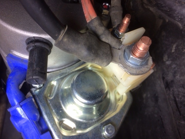

I put an LT1 starter in y car last summer when I was doing my headers. The only problem I ran into was the wiring was not long enough to reach the lugs on the starter. The LT1 starter is a couple inches shorter and GM didnt leave much slack in the wiring. I had to pull a little where ever I could and also had to dremel away some plastic on end of the solenoid where the wiring goes so that the ring terminal would sit down flush.
The car does start different now. Not better or worse but just different. Sometimes I let the key go to soon and have to restart it. Im still getting used to where it "fires"

That's a Nippondenso starter... no wonder the wires didn't reach, they end up sort of toward the bottom instead of up on top. Even with the little whitish cappy thing on the end of the solenoid.
