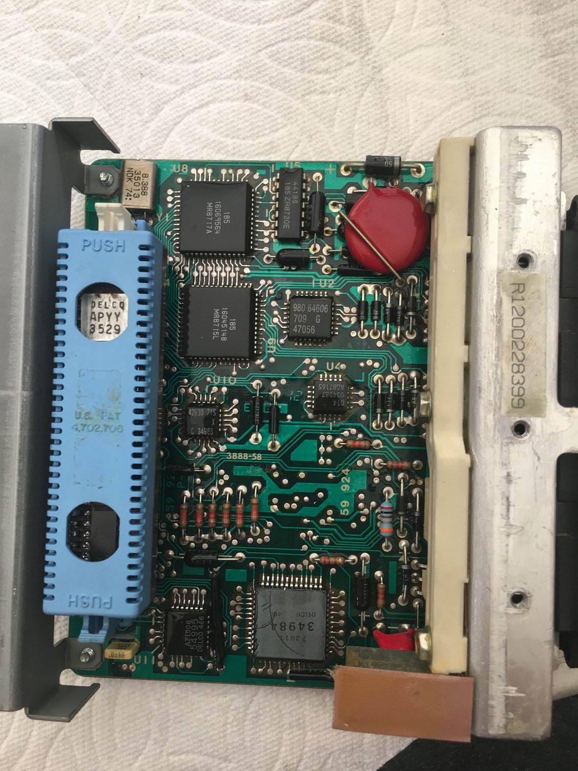

When I was rechecking my base timing (engine cold), I noticed that the timing would jump 4 degrees or so and the idle would would hunt up at the same time. This is WITH the EST bypass connector unplugged so that base timing can be set. I have never seen base timing move like that. It would jump and idle would rise. It would drop and idle would lower.
So I dug into my ECM. Connections and connectors all looked good. I opened it up and cleaned and re-seated the chip. Looks like the ECM was replaced at some point. Everything looked solid. I also played with the TPS seemed to react smoothly when pushed slightly at idle. I did try the EST connector when the engine was warm and likely in Closed Loop. It did reduce RPM, and then back up when I replugged it in.
Car runs ok but I can tell something is not right.

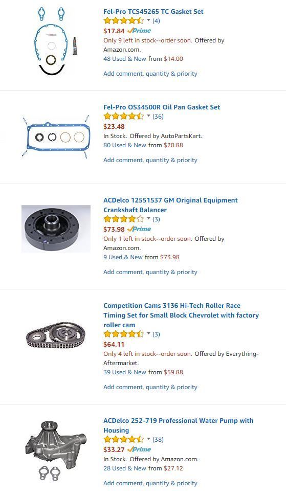

I am now really thinking this could be it. Worn or broken nylon teeth could really cause a rattle.
Though I did not want to dig in into this motor, I am not ready to begin my big motor build so I need to make this one work for the near future. I suppose I could pick up a healthy long block, but man my budget is waaaay over to date.
So, what parts would you recommend? I probably won't put 10,000 MORE miles on this motor (It's a second car for me).
I am planning on doing valve seals and springs but will keep it stock.
My harmonic damper is missing sections of rubber bead, the front seal leaks, and I have a stubborn lower radiator hose leak at the water pump, so it's not a bad place to go digging to cleanup the existing motor.
What parts would you recommend?
Old Jul 31, 2017 | 11:22 AM
ploegi's Avatar
Posts: 1,556
Likes: 28
From: Adrian, Mi, USA
Car: 1988 Pontiac Firebird Formula
Engine: 5.7 TPI
Re: Appealing to the Forum Gods for Guidance - LB9 mild missing/misfiring
Double roller timing set.
Water pump.
Radiator hoses.
Balancer.
And of course, the appropriate gaskets and seals. Solve a host of problems all at once, and since you are already touching every part on the list, no additional work involved.

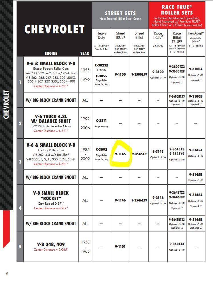

If you want to swap out the engine eventually, you could just buy a cheaper replacement chain for it. No need to spend $65 on something you can't feel the difference in.
Old Jul 31, 2017 | 06:06 PM
Tootie Pang's Avatar
Joined: Aug 2009
Posts: 1,972
Likes: 127
From: Los Angeles
Car: 1989 IROC Convertible
Engine: 350 TPI L98
Transmission: WC T5
What would be a good quality OEM replacement?
Old Jul 31, 2017 | 08:49 PM
Biledriver's Avatar
Joined: Dec 2016
Posts: 187
From: Sebastian FL
Car: 87 firebird 86 c10 90 mustang
Engine: 383 sbc
Transmission: 97 t56
Axle/Gears: Moser 12 bolt 3.73
Cloyes single chain.

Looks like Autozone has the loaner tools - harmonic balancer puller and installer but I didn't find the crank sprocket tool. What can I use for this if I can't locate an OEM style puller? Maybe just a jaw puller?
Cloyes 9-1145 is specd as the dual chain rollercam equivalent for the 305 TPI (F)

Order placed:
