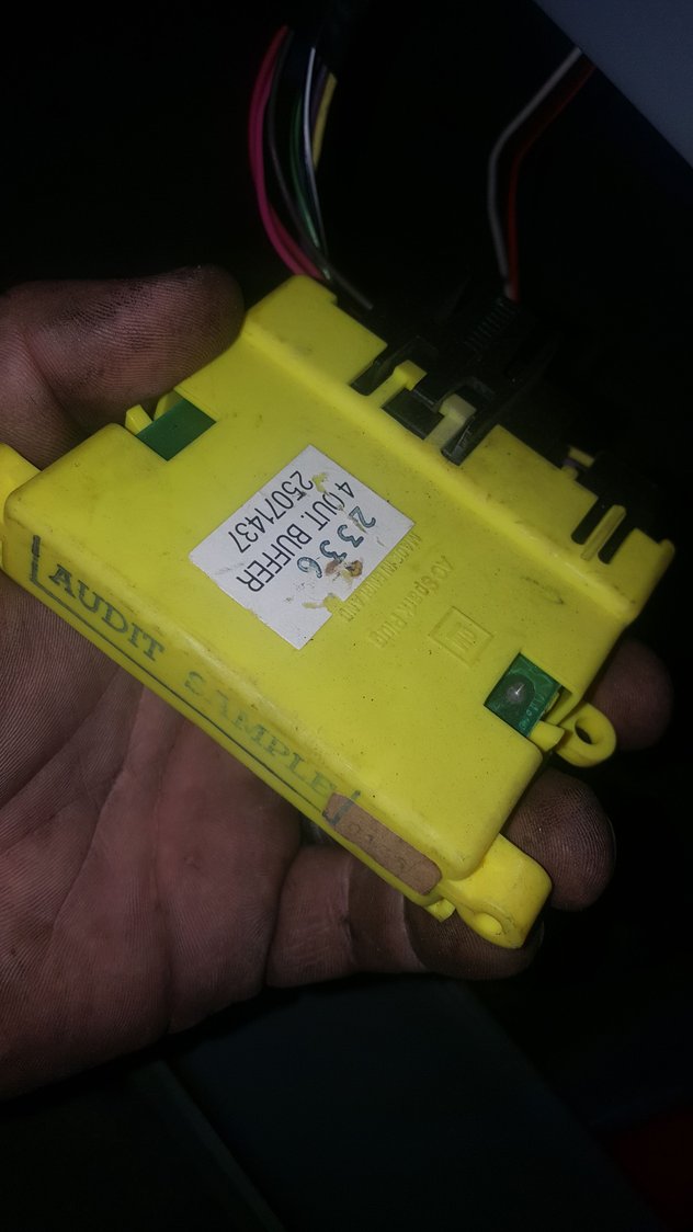

Old Sep 28, 2017 | 04:50 PM
88guy's Avatar
Joined: Sep 2017
Posts: 32
Re: Rough idle
Thanks i forgot to mention it idles at about 1300 till that 2omin mark and its rich and oil pressure reads 60 dont get bk to normal till that 20 min mark and what is this?
Old Sep 28, 2017 | 04:52 PM
Tuned Performance's Avatar
Community Influencer
iTrader: (95)
Posts: 16,927
Likes: 1,016
From: Mile High Country !!!
Car: 1967 Camaro, 91 z28
Engine: Lb9
Transmission: M20
Re: Rough idle
That's a vss buffer vehicle speed sensor signal buffer for the speedometer and ecm.
The oil pressure maybe the sender itself or gauge is reading off.
The buffer mounts on a tab on the ecm holder.
