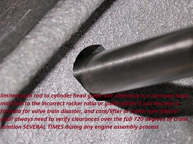

Sounds great on paper, but changing to 1.6 rockers moves the pushrod inwards towards the rocker stud. If your heads have the factory pushrod slot, then most likely a bind will be created. There is a tool made to elongate the slot using a drill bit. It's called a Louis tool. Obviously the process will make cast iron chips that will fall into your lifter valley, unless you are prepared to remove the intake manifold.
Upgrading to 1.6 rockers is not just a simple bolt-on.
Even though you only have 79K miles, your valve springs are 18 years old. You might want to consider changing them.

Most of the time, the springs, keepers, rotators, blah blah blah on the stock valves will interfere with aftermarket rockers. As in they will physically rub. Lots of people have just thrown a set on an engine and never bothered to look and see if they actually cause problems. Lots of used 1.6 full roller rockers out there with rub marks and worse.
The proper way to do it would probably involve new springs, keepers, locks, machine the spring pockets in the heads, have threaded studs installed, new valves without the stupid O-ring groove, a valve job, and check for issues with the rockers while you're in there... But yeah, at that point you're spending money on a 305 when you could be putting the cash into a 350.

Here is a picture of what happens when you swap to 1.6 rockers.
The pushrod moves inward and can create a binding issue.
Attached Thumbnails Doing Valve Seals, pop in 0 roller rockers while I'm in there?-sguide_plate.jpg

I didn't encounter clearance issues with my pushrods. I checked for this while turning the engine over by hand. The consensus seems to be that the stock peanut cam doesn't have enough lift to cause a problem when installing 1.6 rockers on a stock LB9 or L98.
GD

Did quite a bit more reading about the 1.6 ratio rockers. Decided that I didn't need full roller rockers on my otherwise stock LB9. But I also decided that I wanted to help the little cam out. I went with the Comp Cams steel pivot ball 1.6 rockers with a roller valve tip.

I also checked the pushrod clearance manually when rotating the engine, there is plenty of room, no issues whatsoever.
