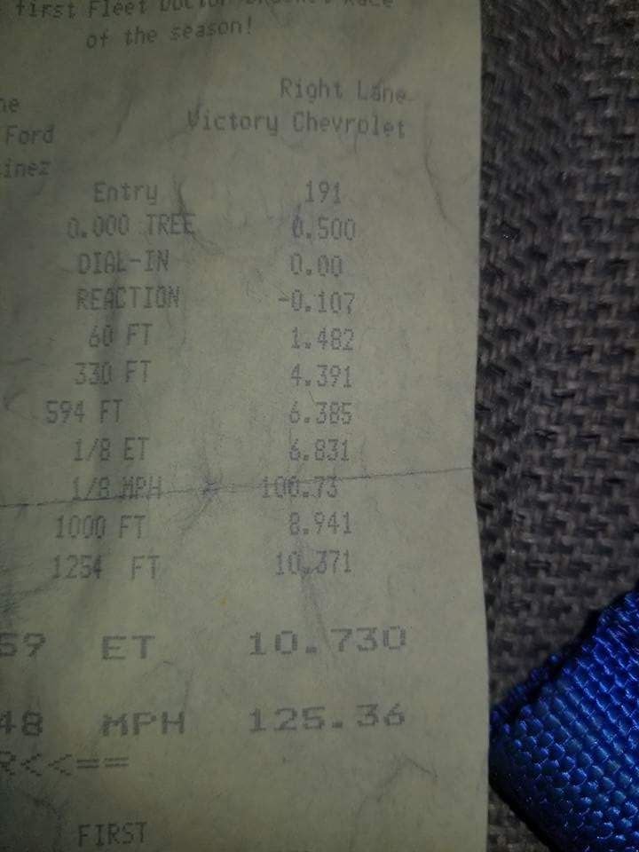

10.98 @ 122 NA
10.35 @ 128 w/100-shot
Attached Thumbnails Post your 10 second or quicker N/A builds.-10.98-slip.jpg
