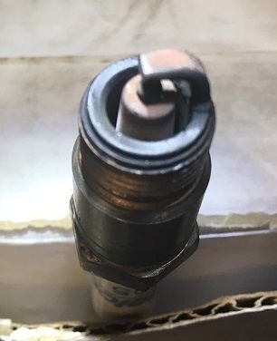

Since I had the plugs out for the compression test I figured I would post them they all look the same and are at .035 gap.

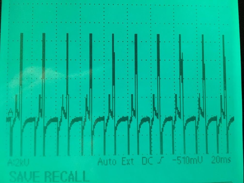

Here is the secondary ignition waveform first one is at idle and the second one is at WOT under load.
I am certainly a newbie using a lab scope but does not look right comparing wave forms in manual and reference waveform on this scope and the duration appears to be very low.

You need to correlate the ignition waveform to which cylinder it's firing. You definitely don't have consistency there. But without knowing which waveform belongs to which cylinder
Do you have a second channel on the scope that you could monitor the #1 plug wire to use for a trigger? Either that or monitor them one at a time.

The inductive clamp was on number one. Looks like I could do a parade pattern that will show all cylinders based off number one and display in the firing order. There is a second channel on this scope but not sure how I would connect this. Or I could just keep testing and move the inductive clamp to every cylinder.

Here is how I am connected for secondary ignition testing and the first scope image is idle and second is WOT. It is a OTC 3840F scope.

Can't really see anything useful without zooming in on the firing line and also comparing it to other cylinders. I would at least try to compare it to the highest compression cylinder being that #1 is the lowest. Can you save a log an open it on a computer to see more details? Do a google image search for secondary ignition waveforms. Can learn a lot looking at waveforms from known conditions.

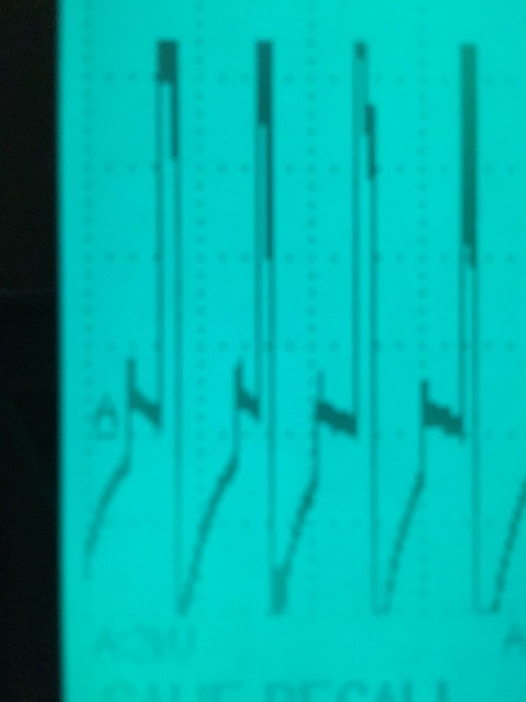

Idle
WOT 2 parts so you can see each cylinder closer unfortunately the resolution sucks I'll make another run.
Old Aug 26, 2018 | 05:29 PM
GeneralDisorder's Avatar
Joined: Mar 2017
Posts: 4,255
Likes: 427
From: Portland, OR
Re: Runs great but no power
Need more resolution or zoom in.... can you change the meter to a 5ms sweep?
Yes, this was the closest I could get with at least 8 cylinders showing then I took a picture of the first 4, and the last 4.

Here is WOT parade at 5ms

It's all still too compressed. Can't see enough detail to make any observations. This is what we need to see:
I'm guessing that the 5ms on your scope means that your graph is 5ms granularity. Try 1ms or even 0.5ms if you have that.

Here is 1ms and I did it in single cylinder mode, the parade pattern compresses it for all the cylinders and it is a small screen I can just do each cylinder this way. Still does not look right once I do a WOT run, at idle it looks normal with voltage per division at 10kV and 1ms.

Is that idle or WOT and just cylinder #1?
Honestly it looks fairly normal. The resolution of the scope leaves much to be desired and it seems like there is significant irregularities from event to event of those traces are for the same cylinder?
It looks like the peak KV isn't showing on the scope - like it got lost in the scaling or something.
Have you considered a laptop based USB scope? Something with a much higher resolution? They are pretty cheap on ebay these days.

Yes WOT cylinder 1 only. I have noticed the Fire kV and rpm during parade getting lost.
Here is another I think looks much better at 10kV scaling and 1ms. If this looks like the right setting I can start switching cylinders. I will certainly look into a USB scope if it will help here.

Secondary ignition can be tough to read but it looks lean. The firing line is very hashed up. This usually indicates a lean condition. It can also be low compression or a cam lobe issue.
The low manifold vacuum is concerning, and the compression numbers are pretty ho-hum. A good compression number on a TPI engine is around 195.
Another easy test is to check the temp of each exhaust runner (easier if you have headers), with either a laser temp gun, or even better a thermal camera.
Given what you have tested so far, I would pull the injectors and have them tested. That needs to be ruled out and injectors are often a problem for TPI's. If that doesn't make much difference the engine is probably due for a rebuild.

I can see from the plugs that it is rich any oil on those?

Yes likely some oil as I do have some oil on restart like the valve seals are leaking.
