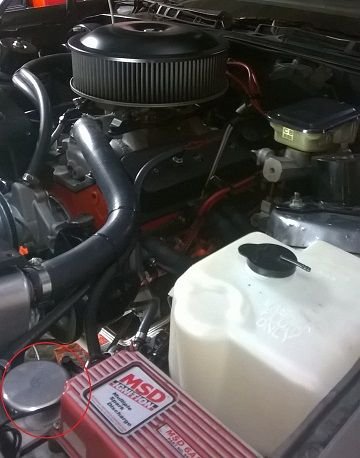

I've had a Moroso catch can installed since I noticed the excessive puffing of smoke from the PCV valve cover hole when it was disconnected. And for the reasons posted above, namely "clapped out rings", I wanted to eliminate or at least reduce the amount of blow-by that would enter the intake.
Mounted up by the rad, it's in from the PCV valve and out to the base of the intake. I can recover an ounce or two of condensate every other oil change or so (although I haven't exactly kept a record of the amounts).
Circled in red beside the ignition box

If all you are getting is condensation, why use a catch can? Condensation is a symptom of the catch can itself (and it not being heated). If you remove the catch can, then the PCV vapors will not be allowed to cool prior to being burned, and the moisture will never form in the first place (see Wikipedia for "Dew-point"). A catch can or AOS is used to prevent the engine from consuming it's own oil. If all you get out of the can is condensation (which is a byproduct of having a catch can) then one has to wonder what possible purpose it serves?
What are your compression numbers?
Dirty intake is often a result of EGR also. It may have nothing to do with the PCV system.
GD

I suppose I should have said "condensation and oil mixture".
Compression is down from what it used to be (and what it should theoretically be as well), and the variance between cylinders is as much as 25 PSI. Leak down tests show unacceptable losses too. So much so that I doubt the accuracy of my testing but at the very least 20% is observed and with one cylinder, not surprisingly the one with the lowest compression pressure, indicating a 50% loss.
"Clapped out rings" is a good definition I would think. And given the history of this shortblock, understandable as well.
