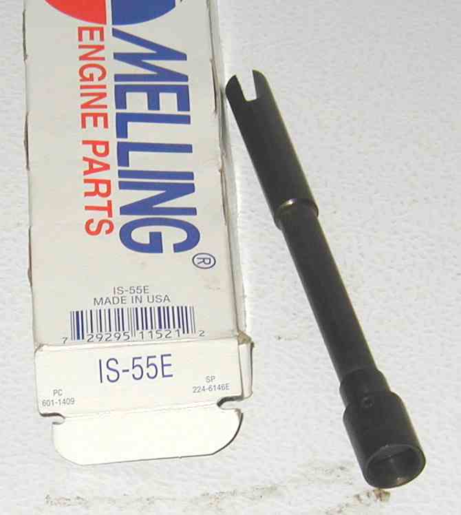

Melling IS-55E
NO drive rod sleeve "fits down into the hole". You put the rod in from the bottom before putting in the pump. (or, put it in with the pump)
Never seen or heard of one with a sleeve... sounds like something that wouldn't work. Speaking strictly as someone who has seen what happens when the crappy nylon type breaks.

The "intermediate shaft", if the sleeve is on it sleeve whether metal or plastic, won't "drop down" to the pump. The sleeve won't fit through the hole. At least not in stock blocks; never built a SHP block but I doubt it's very much different in that regard.
As Alky said, the only way that can work, is if the sleeve is already installed on the pump, not on the rod.
You can use ANY drive rod you want if you install it and the pump correctly, as described in both his posts and mine.
I highly recommend the Melling one because it's about 1/3 the price of the ARP one and works just as well. It was introduced as the stock replacement for some specific application; probably Corvette. Been using it exclusively for over 30 yrs.
