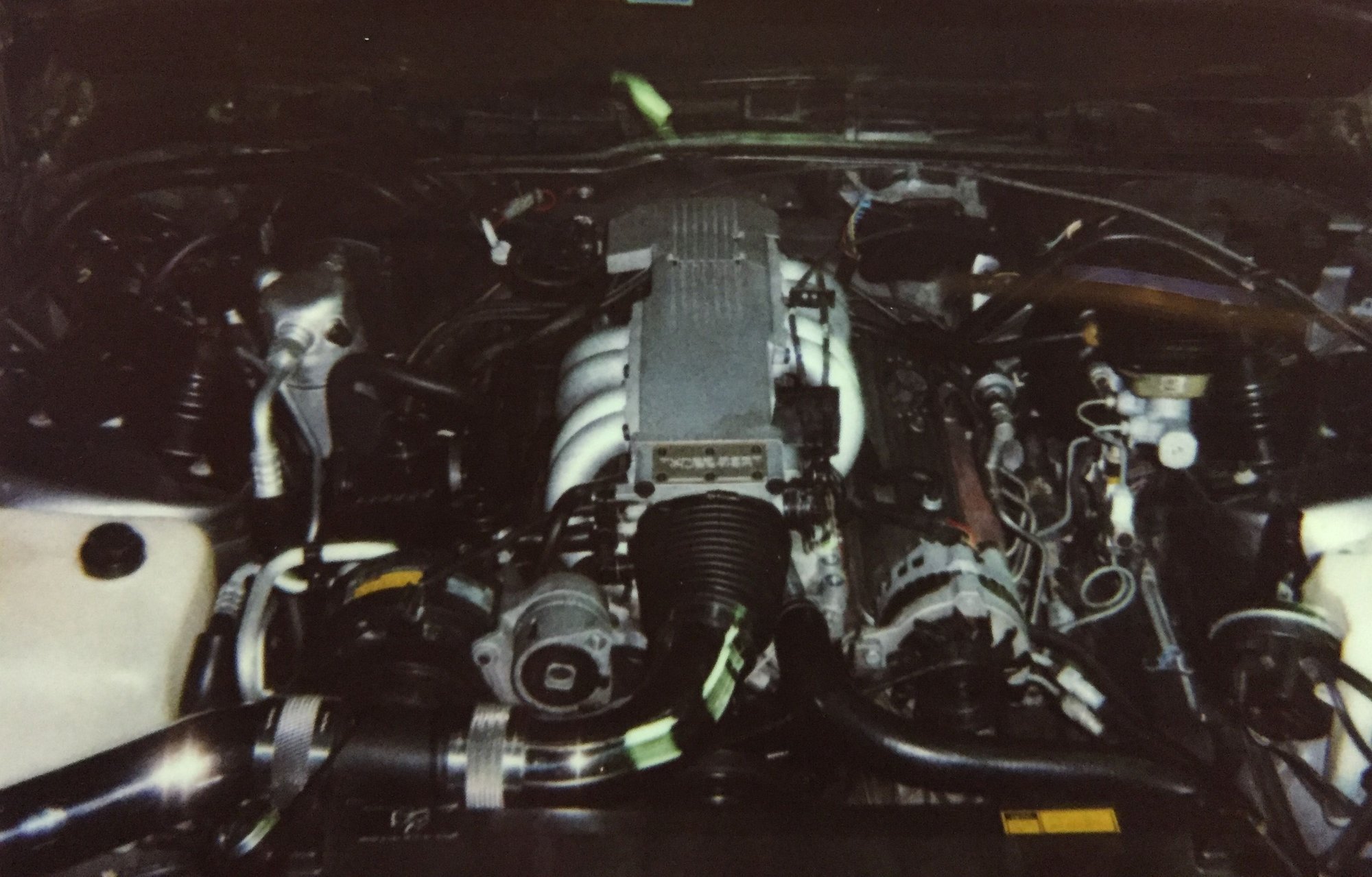

Upgrades: Replace the restrictive air inlet
but for basics: a complete tune up
