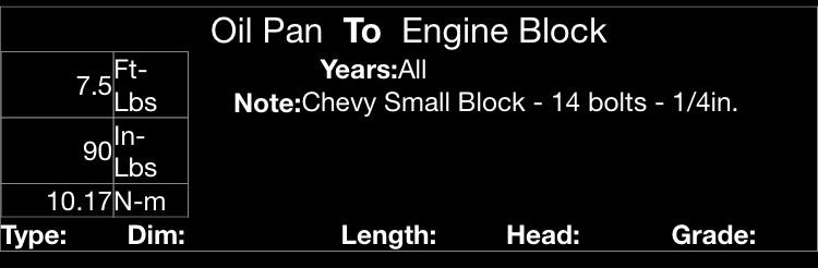

Looking for torque specs for 1991 Camaro Z-28 (5.0L) and specifically oil pan bolt torque and tightening pattern. Thx in advance!

160 inch pounds , tighten from the center out chris crossing.
its not much more than snugging them down.

Thank you. Is that for all bolts...even corners? That’s ~14 ft-lbs which seems a little high, no?

You could just snug them down and call it a day. Onother website shows a lower spec.
