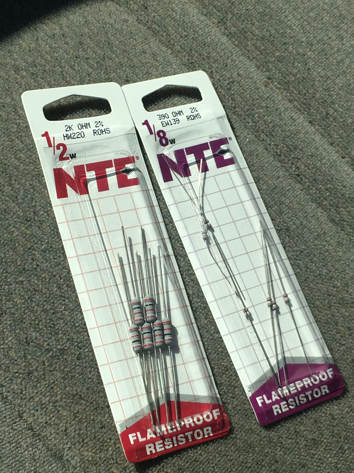

UPDATE: I have it Working now by tying a 2000 ohm and at 390 ohm resistor in series I got 2390 with 2% tolerance. The 20 extra ohms are only .08% of the load, so I am within working limits! The car starts Now, albeit slowly. I will get it warmed up and see what happens next. I really hope this solves the puzzle!!! Fixed for $3.50! If this does in fact bandaid the issue I will add a proper bypass or replace my ignition.
Found these at Frys after about 10 minutes of examining all available resistors, no variable resistors to be found. I thought about adding another in parallel to bring the 2390 down to 2370, but figured I would try one of each of these in series.
I squeezed the connector back together with my series circuit resistor group tied in to the female plug ports from the ignition. I tried it and it didn’t work, but had the DUH moment and realized I needed to snip a wire so that I didn’t have 2390 in parallel with 2370 or some different load reading. Cut a wire and it worked. This proves the key was the fault, so far. It cranks slower now but does fire.

Frys electronics in Oxnard had them. Not a single place in my town had them since our radio shack closed. I have 5 extra of each resistor in case anyone else with a VAT 8 key needs a bypass.
I taped it up and it looks factory now lol. Thanks for the input everyone. The same problem key works fine now with the bypass for the last 2 hours of driving and testing.
