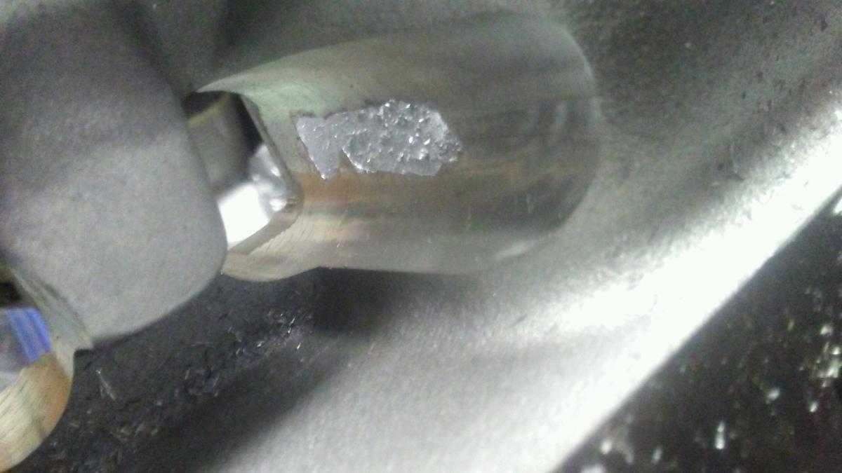

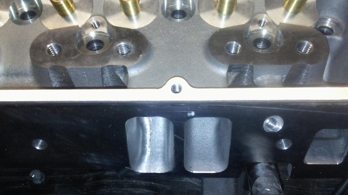

no different than NKB (nice name eh? LOL) BTW these knockoffs out there are not vortec heads.
This valve job waspretty nice actually....guides not thrilled about. Go past surface deep in the casting you better be careful
I found a void by accident the last (suits my charlie brown luck) pushrod pinch...should have been at least another .050 left before I stopped but wasnt
Epoxy woulda done ok but still pressed a bushing in the other side then used epoxy for the heck of it. There was simply a casting void....seen 1 teeny pinhold pushed on it and one large piece fell right out. LOL
That stuff happens, no big deal.

Old Sep 16, 2019 | 02:59 PM
cuisinartvette's Avatar
Joined: Feb 2006
Posts: 1,777
Likes: 27
From: Sanctuary state
Car: 67 ******mobile
Engine: 385 Solid roller
Axle/Gears: 4.11
Re: Best flowing SBC Head under $1000
Old Sep 16, 2019 | 10:52 PM
NoEmissions84TA's Avatar
Joined: Feb 2017
Posts: 4,185
Likes: 576
From: Meriden, CT 06451
I did the same to my Edelbrock Performer RPM heads. But it was a big deal in my case because I was forced to use offset rockers to get everything correct.
