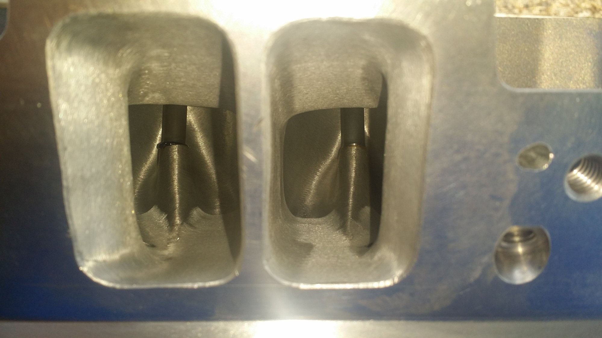

I finally had a chance to go pickup these heads from Lloyd yesterday.

Look pretty good. Floor at the short turn looks high and alot of turn angle. Could be the pic but if not i would have thought the floor would be lowered over the turn
i hate trying to get headers for square ports lol but alot of heads do that
