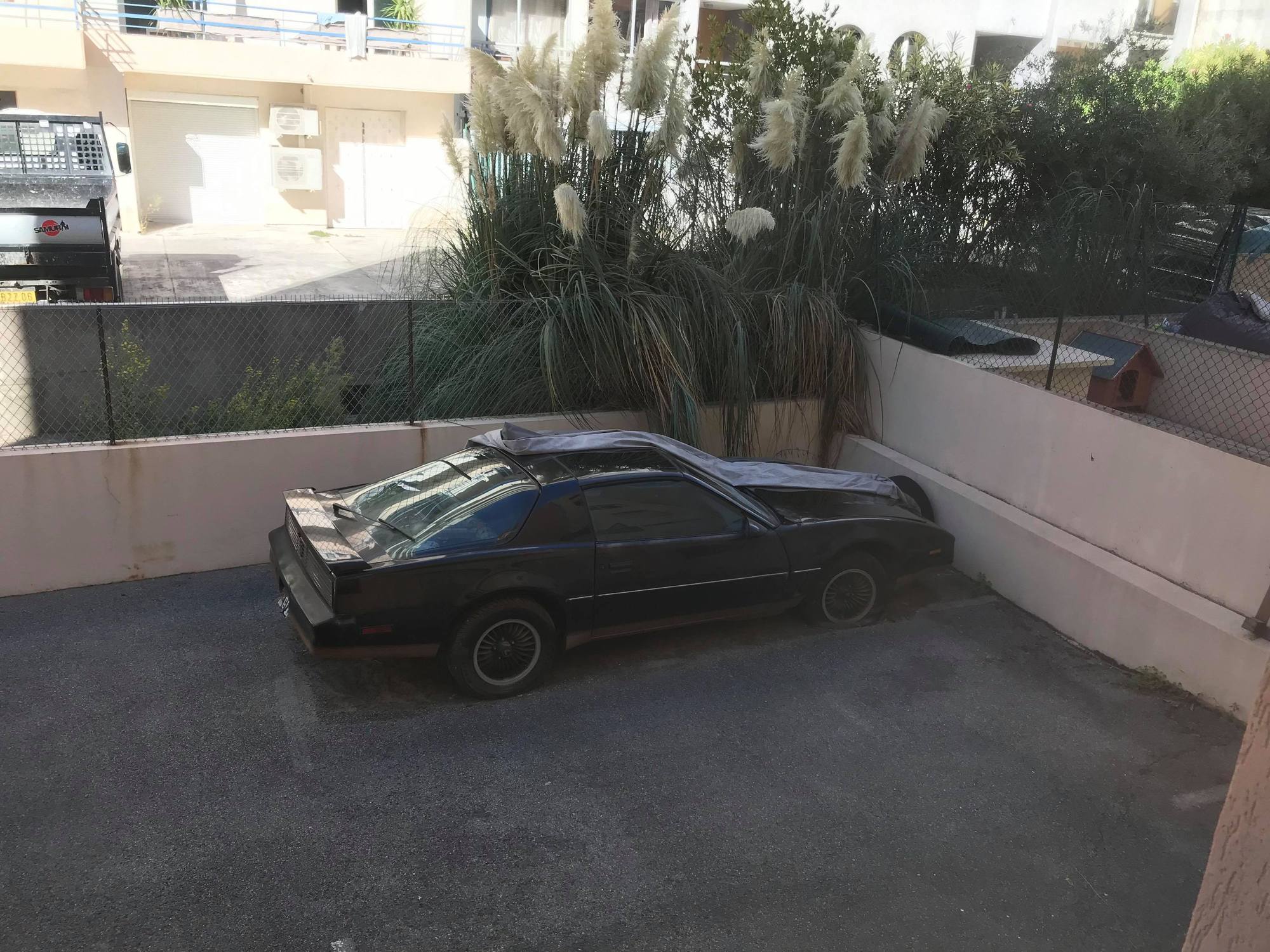

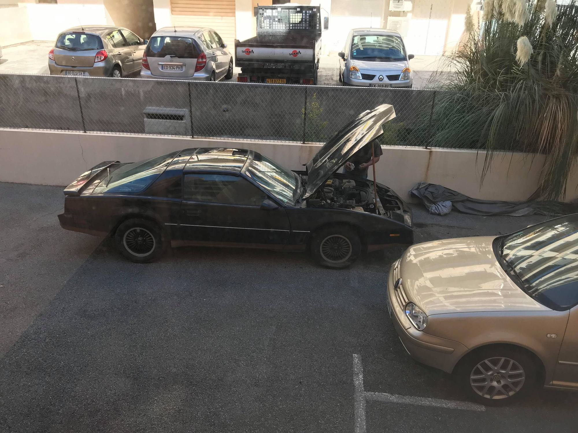

Hi
This is time to wake up my 1983 Recaro T/A, after 10 very difficult years of many changes.
I ordered emergency parts on Rockauto : belts, hoses, oil filters, transmission filters, windshield wipers. That will help.
But I need some other hoses. This CFI 305ci has been converted to Edelbrock carb through a real LT-1 1970 intake. And fuel hoses are shot.
So I'd like to go with black braided hoses.
This is what I found : http://www.proflow.com.au/Catalog/502497
But the question is : how can I convert my stock radiator and Edelbrock carb to braided hoses ? What's the way to adapt fittings ?
Remember I live in Europe. We don't know much about F-Babies.
THX.
Sleeping for too long !
Don't laugh at the V5 Golf. She gave the power to inflate tires.
