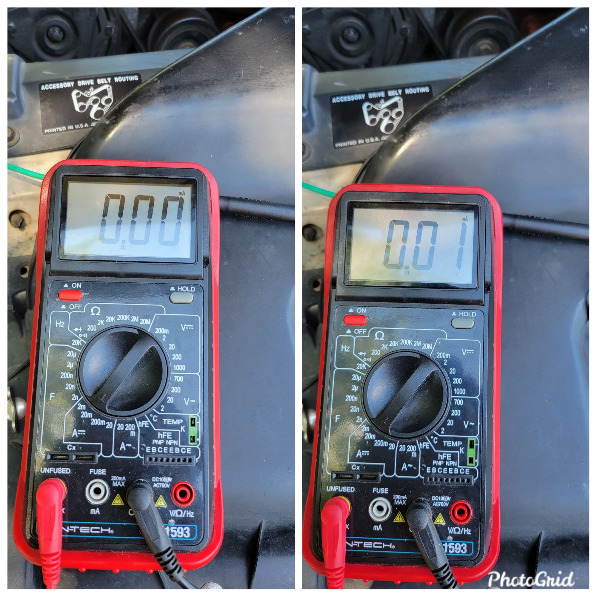

Ordered new Standard Motor Products PS228 Oil Pressure Switch & Performance Tool OPS Socket with Amazon Prime One Day Delivery, they arrived today, the install was painless and damnit let the DMM say the rest... Yes that's with the new OPS installed and connected, it kind of rapidly fluctuates between 0.00ma and 0.01ma draw.
I'm stoked, and hope this finally fixes it because its been a nightmare lol.

Looks promising

Try connecting to the mA jack instead of the A jack. The shunt in the meter is drastically different, and may not be providing a correct meter indication.
