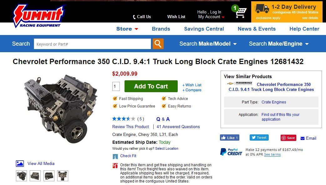

It would be less expensive to buy a 350 crate engine than to properly rebuild a 305. You're not gonna get 250 hp from a 305 without after-market heads. If your on a tighter budget, try to find a good used 350 that still has some life left in it. Read the Sticky on the V-6 to V-8 engine swap. Off hand, I can tell you that you need V-8 motor mounts, fuel lines must be moved to the passenger side, a full exhaust system and front springs (as already mentioned).
What you really need is a complete V-8 equipped thirdgen donor car...

For the $ Id orderup a base GM crate for 2k he can still learn about engines

My Goodwrench 350 crate has around 245-250 hp (probably 260 if it had headers) with bigger bore, intake valves & ports than a 305, a mild Comp performance cam, and 740cfm Quadrajet. The heads are the weak link...
