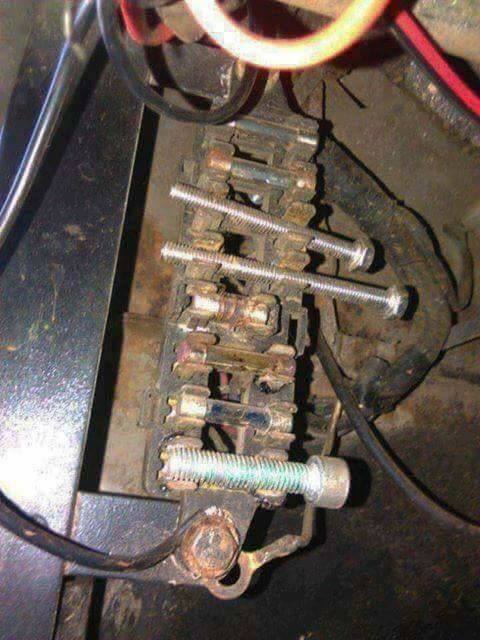

In unrelated news, Something's up with the electrical system - previous owner is/was "a professional electrician", and he put in a new radio. He wired it to the same circuit as the door locks and the hatch solenoid, and stuck a 25-amp fuse in place of the 20. It doesn't charge much at idle and it'll blow the fuse if you try to pop the hatch with the radio on. Fun stuff!
Keep looking - you might find something like these:

Re: Looking for more power on the cheap - '84 Z28 305
My favorite's the 45-amp auto-alert fuse. The 2000a slow-blow is a close second.

Always good to REPAIR a broken car before trying to "modify" it... there are few things more hilarious and misguided than driving by somebody bolting some KROME gadget onto their immobile lawn ornament with grass growing through the wheels.
The radio does in fact require 2 power feeds: one controlled by the ign sw (duh), and one that's hot at all times, to keep the clock, pushbutton memory, etc. alive. Why this individual didn't just use the wires that the factory provided for the purpose is and shall forever remain a mystery. Which I guess shows that just because someone is a "professional electrician", doesn't necessarily mean that they understand how a car is wired. Maybe they can handle houses (or maybe not...) but even so, knowing the one thing isn't automatically guaranteed by knowing the other.
