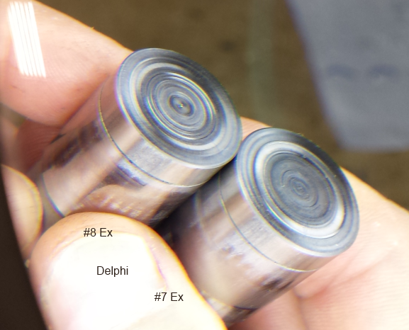

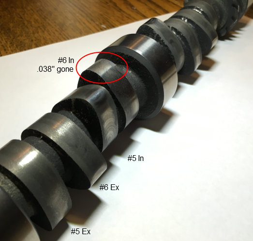

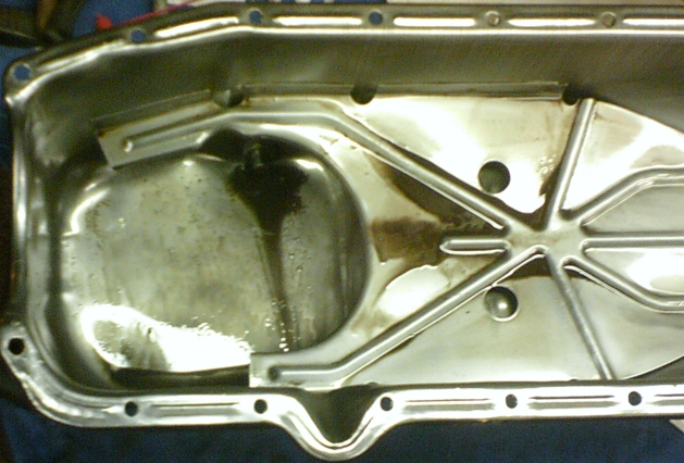

1 & 2 intake are WAAAASTED. DESTROYED. #6 exhaust isn't far behind.
You can't put that back in a motor. It's already full of metal chips.
Stop where you are RIGHT NOW. That needs to go in the trash. Hate to tell you that, but... it is what it is.
Even changing out the cam & lifters, which "nominally" seems like it ought to restore the motor to function, is probably going to fail. ALL of that metal that used to be on those lifters, PLUS a bunch that used to be on the cam, is now in the oil. The filter ALMOST NEVER catches all of it.
Sorry to be the bearer of bad news, but that thing is TOAST.
You can try replacing the cam & lifters but I don't see a year there. If you want to try that, get the cheeeeeeeeeepest cam you can get, and accept whatever comes after. I'd suggest this one https://www.summitracing.com/parts/sum-k1102. Not because it's so "good"; but because it's CHEEEEEEEP, and it's OK for the motor you have, and it's probably not going to matter anyway. But in case it DOES work, you'll probably be happy with it.
If the timing set still has a chinesium sprocket with phenolic (plastic) gums, replace that too. Otherwise it'll be the next thing leaving you sitting by the side of the road.
Yeah, that was disheartening to see..explains why it didn't run like it should, LOL. The other bad thing is i need to be able to drive it at least to move the car from the garage to the front of the house from time to time . Promised the wife she could have the garage back before summer. Soooo I will probably have to go the route of the CHEAP cam/lifter you suggested. I REALLY do appreciate everyones input. Y'all are great and I'm glad to have the TGO to help us rookies.

My opinion is drain the oil, get a Summit Kit, some Howards Z28 Valve springs since you've got the heads off throw it back together and send it till you get a new bullet to throw in. While not absolutely certain the 250-300 is worth the risk IMO to get it back together and see if it holds together. 100% admit it's a toss of the dice but I've done it myself before with a Pontiac engine and did okay on it.
The exception may be if you can find another cheap small block to throw in. I'd be real inclined to dig up a Vortec 350 long block and an aftermarket carb intake if possible and go that route. You'd make quite a bit more power and not be into that much bank.

I say this because I 100% agree with Sofa on this one , with all the metal that's been pumped through that engine's bearings it could die a month after you spend the money for the cam , lifters , gaskets , and all the other incidentals needed to put it back together . You already know you want to keep the car for a long time , and any dollar you spend now on an engine you intend to throw away next year anyway is literally just pissing money into the wind , money that could be getting you closer to the engine that we both know you really want to be in the car .

Yeah that's an unbelievable BUMMER. I feel your pain.
Problem will be, the metal chips and debris from that cam failure, is all now in the crankcase, where it can get into the oil; and the filter NEVER catches all of it. It doesn't take very much finding its way into the bearings to ruin them and the crankshaft, and of course, that's DEATH to the motor. In fact I think I see chips on the base of some of the other lifters. Having also had that happen to me more than once, like NoEmissions, I'd put the odds of it ever being useful again without a rebuild, at less than 25%. It's not "absolutely certain" that it's smoked, but the odds are definitely not in your favor.
You're at a fork in your path. If I may quote a famous idiot, or maybe he was so smart that none of us were on his level enough to recognize it, "when you come to a fork in the road, take it".
I guess your choice now depends on how lucky you feel. My advice would be, spend as little as possible on it (which would be, zero), and instead accelerate your plans for replacing it. If you decide to try to repair it, spend as little as possible while assuring the best chance of success... cam & lifters, springs (the Howards ones are fine), timing set, gaskets. Find some kind of magnet you can stick into the oil drain plug hole and use it to sweep as many metal chips as possible out of the pan. Get a magnetic drain plug. Change the oil and filter RIGHT AFTER the first startup, and every couple hundred miles afterwards. DO NOT use synthetic oil; Rotella 10W-30 is probably the best eeeeeezyest cheeeepest choice. Use either break-in lube or a THIN smear of moly grease on the new cam and lifter bases; if you use moly, don't use very much, as it ends up plugging oil filters and laying in the bottom of the pan like a sludge, if you get carried away. When startup time comes we'll help you through break-in process, which is necessary nowadays although in times gone by it wasn't really much of an issue, because of the way oil has changed in the last 20 - 30 years.

I would also suggest, if you are going to try to revive it, use the magnet to get as many shavings as you can out of the lifter gallery, under the intake manifold. Shavings are bad. Make as many as possible go away.

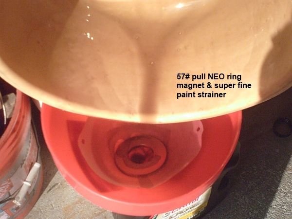

As others have said.......try to flush away debris. Hopefully it is more powdered, than chips. I would get a gallon of mineral spirits(often called Paint Thinner) and, with the oil drain plug out, pour the spirits into the valley and wherever you can. rock cam kits start at $ 65.00. Oil and filter change, maybe a minute after start up. FIND some oil with ZDDP and use Molly assembly lube on the cam lobes. Soak the lifters in oil, for a few hours before instill. Good luck!
https://www.amazon.com/s?k=zddp+motor+oil&ref=nb_sb_noss_1 https://www.amazon.com/s?k=zddp+motor+oil&ref=nb_sb_noss_1
Use the cheapest ZDDP OIL OR ADDITIVE, especially for the first 30-60 second run.

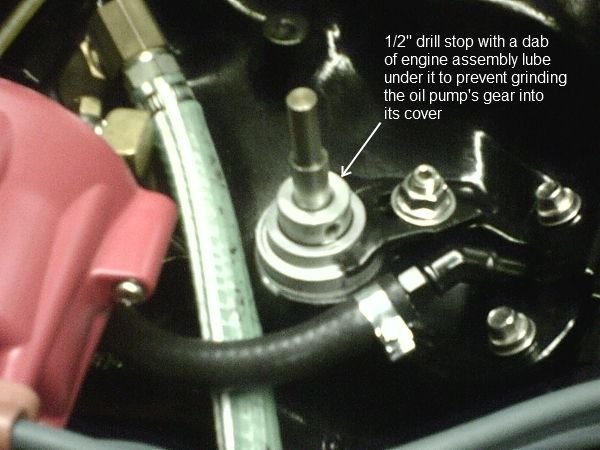

Cleanliness is godliness, pull motor and install it on a stand then you can pull the oil pan to wash it down.
if you want to remove the rotating assembly, to clean all the parts, you can do that too and you can give the main, rod, & cam bearings a visual inspection to make sure OR just leave the bottom end together and wash it all with kerosene, or diesel.
if you take it apart keep the rods on the pistons & number them so they go back in the same holes, same with the main caps.
Then you can dingle ball hone #6 hole. The old rings will re-seat because the hone cross hatching gives them something to "grab" onto.
Hopefully you just chewed up those lifters because the engine sat so long without starting and was dry/stuck on startup OR that was why the car was parked in the first place.. before you put back the motor back in the car pull the distributor and prime the oil pump to get oil thru all the pushrods and on the valvetrain.
good luck.
we all want to hear a motor run but when a motor has sat for many years next time be sure to do 4 simple things before starting it.
1. change the oil and filter
2. try to turn the crank by the crank nut to make sure the bottom end will turn, if not you stop right there because something is "stuck" and will break/damage other parts.
3. pull the valve covers off and prime the oil pump to get oil pumped thru all the pushrods and onto the valve train, this also gets oil to the cam and lifters to prevent a dry start
4. bump start the engine to check the valvetrain action; a sticking; rocker/pushrod/ lifter can be spotted and addressed before damaging an otherwise "good" engine.

OP might want to cut open the oil filter, and see if the metal is in dust form, not chips/flakes.

My 334 (stroked 305) ended up eating the cam & lifters in 19K miles. I already had so much money into this thing, that I had to resurrect it.
So I spent a bunch more money and fired it up on my engine test stand. After the 20 minute cam break-in, I had a tick. Turns out that the "Guaranteed Made in USA" Skip White lifters were actually cheap offshore made crap. The pushrod cups were not correct and as a result, would not pump oil to the rockers below 1300 rpm. But it took only that 20 minutes to destroy my new camshaft.
So here is what I did, and I suggest you do the same if you are going to "roll the dice".
Drain the oil. Install a new cheap oil filter. Put the lifters back in the block. Get about 4 gallons of either diesel fuel or kerosene to flush the block. You will also need a "prelubing" tool that you spin with a drill motor to run the oil pump. It must be the type that seals the pass side oil passage around the distributor shaft. You can also make one from an old distributor.
Pour all 4 gallons into the lifter valley. Let it work for about 10 minutes. Drain and strain through a fine paint strainer. Repeat as many times as necessary until you don't see much crap in the strainer.
Now pour it in again but this time you will run the oil pump to flush the passages in the engine block and the bearings. Rotate the crankshaft 90 degrees every so often. DO NOT USE THE STARTER MOTOR! Drain and strain as many times as necessary until you are satisfied that the block is as clean as you can get it.
Here are a few pics from my flushing:

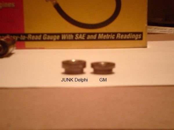

Get yourself a quality roller cam and lifters so you don't have to worry about wiping the new camshaft. Maybe you can get edelbrock flat tappet made is USA but I would confirm that.
I say this because the Quality Control on new flat tappet lifters is horrible, (all the cheap flat tappet cams & lifters are chineseum made.) You don' want to repeat this process because you will get burned and then spend more $$ on tuition.
if you go the 350 SBC route later on you can re-use the new roller cam and lifters, if you go LS route later on you could part it out when you sell the 305.

Originally Posted by -=Z28=-
Did I miss why no compression in 6?
Flat cam, valves on that/those holes were closed all the time, what won't get in, can't get out.
I thought the #6 lifters looked ok. 1 was on the edge. 1 and 2 lifters were chewed up according to the pic unless he mixed them up. Scroll up and look at the pic. It's why I asked. Also, yeah, they are fed, but they had to of been opening the valve some no?
I saw two chewed up lifters at a glance, would assume (I know) the cam was flat as well. A flat cam lobe look like a smaller journal, pretty much round. If the cam/lifter had some "bump" to it, might need a real super accurate gauge to see a few PSI.. 0 could have been 10 psi...and not be seen.
