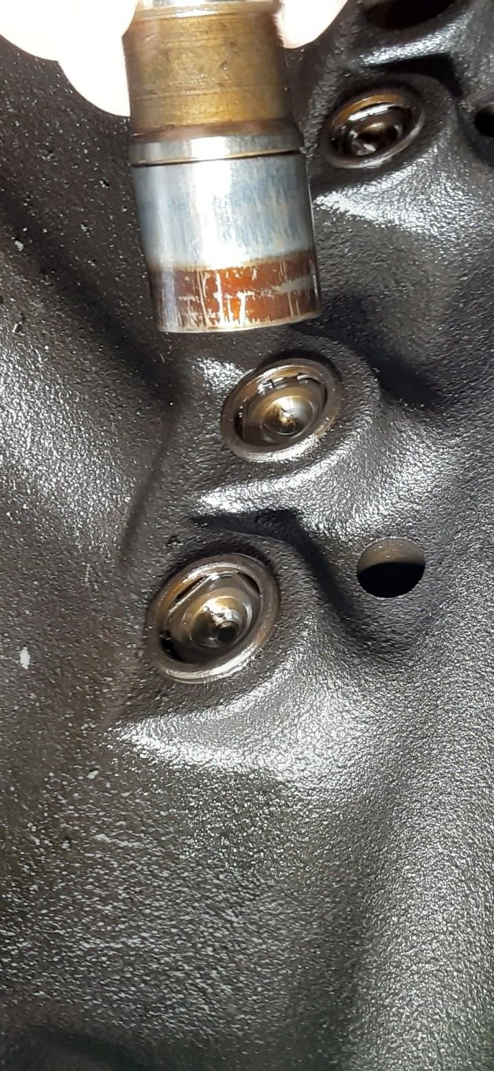

Confirmed, the piston does move when i turn the crank..HOWEVER, I pulled the intake lifter, it was a little tough to pull out, seemed to catch when it was almost pulled out...it finally did release and now moves in and out with out catching. I did find several scratches on the sides of the intake lifter(see photos) the other lifters did no have these scratch marks...Could it be the root cause of the issue? Based on everyone's input I'm going to assume it's not the rings causing the ZERO compression. I will replace the valve seals and reinstall the heads. Should i replace just the one scratched lifter to eliminate that as a possible cause or do you need to replace all lifters if you replace one?

well you could re-install the head and pressurize the cyl with air and see if you can hear it leaking out tailpipe or in intake or crankcase - this does seem odd with no easily visible failures that this would have ZERO pressure in #6 - tou can tell that the cylinder isn't firing

Re: 305 #6 Cylinder zero compression- ball hone and new rings only?
For an engine that sat that long, there's probably a lot of parts varnished up that can stick. Take each lifter out one at a time, polish the sides up with some 600 grit wet/dry paper and some light oil, clean them up and put them back in the same hole they came out of. Do the same with the valve stems, then lap them to see if they will seat ok. Once that's all good, put it back together with some new gaskets and see what happens. I think I would get some new steel shim gaskets as to retain the correct quench... is this carbureted?

Yep, all the lifter have a varnish build up on them. Thanks for the suggestions, i will do that to each lifter. I have lapped the valves on one of the cylinder heads and and I will start removing the second head to do that one as well.

That's VERY GOOD. It's entirely possible for a motor with a broken rod to still RUN albeit not very good. In fact, in the mid-late 70s / early 80s when times were hard, my late little bro who didn't have a job sometimes, used to put his phone # in laundromats and C-stores and such. You might remember, back in the day you'd write (they hadn't invented printing yet) what you would do, child care or home improvement or personal services or car repair or whatever, on a sheet of paper, and then make like a "fringe" of little strips on the bottom with your phone # on them. D00d pulled one of the strips, wanted an engine swap in his truck. He pulled the truck up into the driveway, ran like s*** but still RAN, pulling a trailer with a motor and this big-a$$ hairy 4-speed out of a school bus, and wanted the motor put in his truck. Turned out his truck had a broken rod, with the piston jammed up against the head and (of course...) not moving, but it still RAN. So, ummmm, … yeah. It could happen. Glad yours isn't that bad off.
Believe it or don't, the SINGLE MOST POPULAR repair he got calls for, was AC. I'd go out and help him sometimes after work. I bet he did DOZENS of AC systems, start to finish, over that period. Maybe 50 or more. We got REAL GOOD at making the little old ladies happy because their cars weren't sweatballs any more. They'd GLADLY pay whatever he charged them, plus a nice tip, because we'd get their air blowing COLD, in an afternoon, and it would STAY that way. Sometimes even invitations to meet their granddaughters. Which I guess is a decent enough work spiff, even if some of em weren't exactly my type. I certainly enjoyed it to the fullest regardless. After awhile they started referring their friends and he didn't even have to post on the CORK bulletin boards anymore. Lots of granddaughters. We did 4-speed transmissions too (my specialty, especially T-10s) and got LOTS of Vette business. Stories for another time.
Anyway, enough of that. Let's hope cleaning it all up and unsticking everything restores it to happiness.
WD-40 will dissolve that varnish reasonably well, and of course leaves it well lubed and waterproofed, for a short while at least. It's good at unsticking stuck rings too. Great stuff for neglected motors.

Make sure every valve, and every lifter goes back into the hole from where it came.
I would also clean out both lifters for cylinder #6. What do the lifter bases look like?
I hate to even mention this, but now is the time to replace the timing chain and gears, esp. if the factory plastic toothed gear is still in there. You can got a partial look at it through the 2 round oil drainback holes at the front of the lifter valley.
NoEmission, Thanks i will make sure to put them back in each hole The lifters have a coating of varnish on the bottom quarter of them(car sat for 20yrs+). i will check out the the timing chain and gears...thanks for you input and the tip!

Take a 2x4 and drill some 1" holes in it as shown (not all the way through). Label with a Sharpie. Put your lifters in it (in order) upside-down (flat sides UP) and take and post the picture. There is no sense in doing any of this work if your camshaft and lifters are worn.
Well...found something i didn't expect ..not sure if the photos shows the details well enough but, take a look at intake lifters 1 and 2..chewed up! they have a significant dish to them ..All other appear good, other than the varnish build up. Some scratched in the varnish in the sides of # 6 lifter so guess it stuck open giving the ZERO Compression. Is it salvageable if change the cam and lifters? Again just trying to get it running well enough to drive for a year of so before swapping. let me knwo yalls thoughts!

Yup, that cam's toast. All that metal went through the engine. Flat tappet cams are pretty hard to keep alive anymore.
I suppose you could bolt it all back together and run it til it dies... I wouldn't waste the money on cam/lifters only to have them get destroyed by all that metal that's gonna be getting washed around by fresh oil moving...

1 & 2 intake are WAAAASTED. DESTROYED. #6 exhaust isn't far behind.
You can't put that back in a motor. It's already full of metal chips.
Stop where you are RIGHT NOW. That needs to go in the trash. Hate to tell you that, but... it is what it is.
Even changing out the cam & lifters, which "nominally" seems like it ought to restore the motor to function, is probably going to fail. ALL of that metal that used to be on those lifters, PLUS a bunch that used to be on the cam, is now in the oil. The filter ALMOST NEVER catches all of it.
Sorry to be the bearer of bad news, but that thing is TOAST.
You can try replacing the cam & lifters but I don't see a year there. If you want to try that, get the cheeeeeeeeeepest cam you can get, and accept whatever comes after. I'd suggest this one https://www.summitracing.com/parts/sum-k1102. Not because it's so "good"; but because it's CHEEEEEEEP, and it's OK for the motor you have, and it's probably not going to matter anyway. But in case it DOES work, you'll probably be happy with it.
If the timing set still has a chinesium sprocket with phenolic (plastic) gums, replace that too. Otherwise it'll be the next thing leaving you sitting by the side of the road.

Unfortunately, this is exactly what I expected to see. Sorry.
You will find that the 2 lobes where those lifters were are now round.
All of that cast iron has been circulated through the entire engine - damaging EVERYTHING. Ask how I know.
Your bearings are now destroyed, at the very least. The smart thing to do at this point is not to put any more time into this engine.
