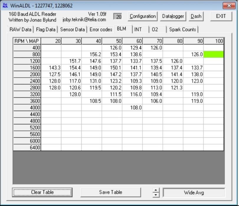

It is not a made up story by any means. I put the TBI setup on a 305 I built using 081 heads and it ran like poop. Advanced the timing 6-10* and put 350 injectors in it. Ran better but did not run right until the ECM was tuned. RBob put TBI on his LG4 Elcamino and tuned a file for it when testing the EBL. His non-swirl port head calibration for that LG4 that he actually includes as a base tune file with the system is very different than a swirl port head. It actually ran said engine I built very well with minimal changes.
You really think you know it all and seriously do not. the TBI PCM run TPI is a perfect example of it will run down the road but was far from being in a good state of tune.
There are guys that have swapped 350s in place of 4.3Ls and driven them down the road with the stock 4.3L V6 ECM a few even with the stock 4.3L injectors in place. Does not mean that 350 is even close to running right either.

Had to go back into data from 2 decades ago on my ancient Dell laptop that I have had since 2004. This is how bad the fueling can be off using non-swirl port heads on a swirl port head based tune. This was a TBI system from a 350 on a stock LE9 305 bored 0.040" over, stock compression ratio flat tops to replace the OE flat top pistons in that engine and the factory 929' spec 194/203 cam with 081 heads in place of the 601s using a 305 chip with the timing bumped up a bit. I went with the 081 heads because they had the bolt holes to run the later serpentine setup. The system was hitting both upper and lower BLM limits on fuel trim adjustment. With the 305 injectors and 305 chip it would not even pull itself down the street it was so lean at lower rpm under throttle. The only time it ran well was in power enrichment on the stock 305 chip and injectors, the rest of the time it was lean running, backfiring, surging disaster that liked to stall often.

When he gets it together and it runs like crap, I will tell you that I told you so and offer tuning help to make it right. I am not cherry picking anything however you are with your sole crossfire 400 example that you claim ran so well. The old Goodwrench smog era 350 ran the same way under a TBI system as my old 305 ran. It ran about well enough to know that it was not happy running. I fixed that one too. I have fixed enough of these tuning them over the years I know what works and does not work well.
I also find it funny, that old turd made over 200 whp and 270 wtq after tuning it. Stock tune it made 178 whp and like 240 wtq. The torque curve was much smoother and it was no longer so lean under load that it had obvious seat of the pants drivability issues.
TBI has a reputation for being finicky with engine changes, which it very much is and that all revolves around the tuning being wrong. Guys get fed up with the drivability issues and dump the TBI for a carb. I see it all the time in the GMT400 world.

The C3 ECMs also do not store any long term fuel trim data after the key is cycled unlike the P4s. With the fueling being as off as the BLM data shows it to be it takes a while for the slow processor speed of the C3 to adjust everytime it gets to the various BLM cells. The P4s such as the 7427' are much better in that regard and tolerate changes better on stock tuning. I could tell the difference with the P4 right away compared to the old C3 even before I tuned the P4.
