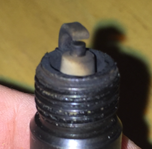

What do you say about this one? Ok or any trouble?

Looks pretty normal. Looks just like the plugs I pulled from my 305 a few days ago. Dyno tuned and running excellent at 186 RWHP.
You have a light tan/whitish insulator without any speckling, no deposits to speak of so it's running hot enough..... I see no problem here.
Do you suspect a problem?

Looks like it idled alot right before it got pulled; not the best circumstances for plug observation. Not very old, probably less than 2k miles.
Is there a reason for asking about it?

Impressive! Thanks!
The car idled for about 20 minutes before shutdown. And they are not very old.
The reason I asked is because I”m hunting down a hot start problem. I suspect leaking injectors or maybe s weak spark. Just had to be sure that the spark plugs wasn”t the culprit.
