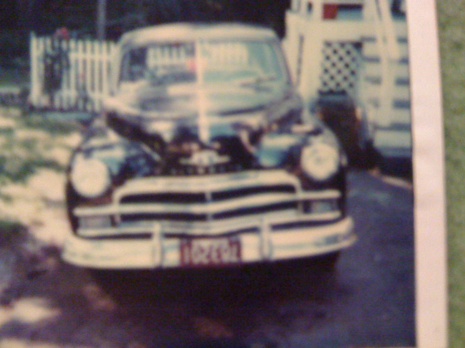

This was the last car I had that used a canister filter , Do I miss the car , sure , , , Do I miss doing the oil & filter change on it , Nope , I don't miss that mess in the least .
