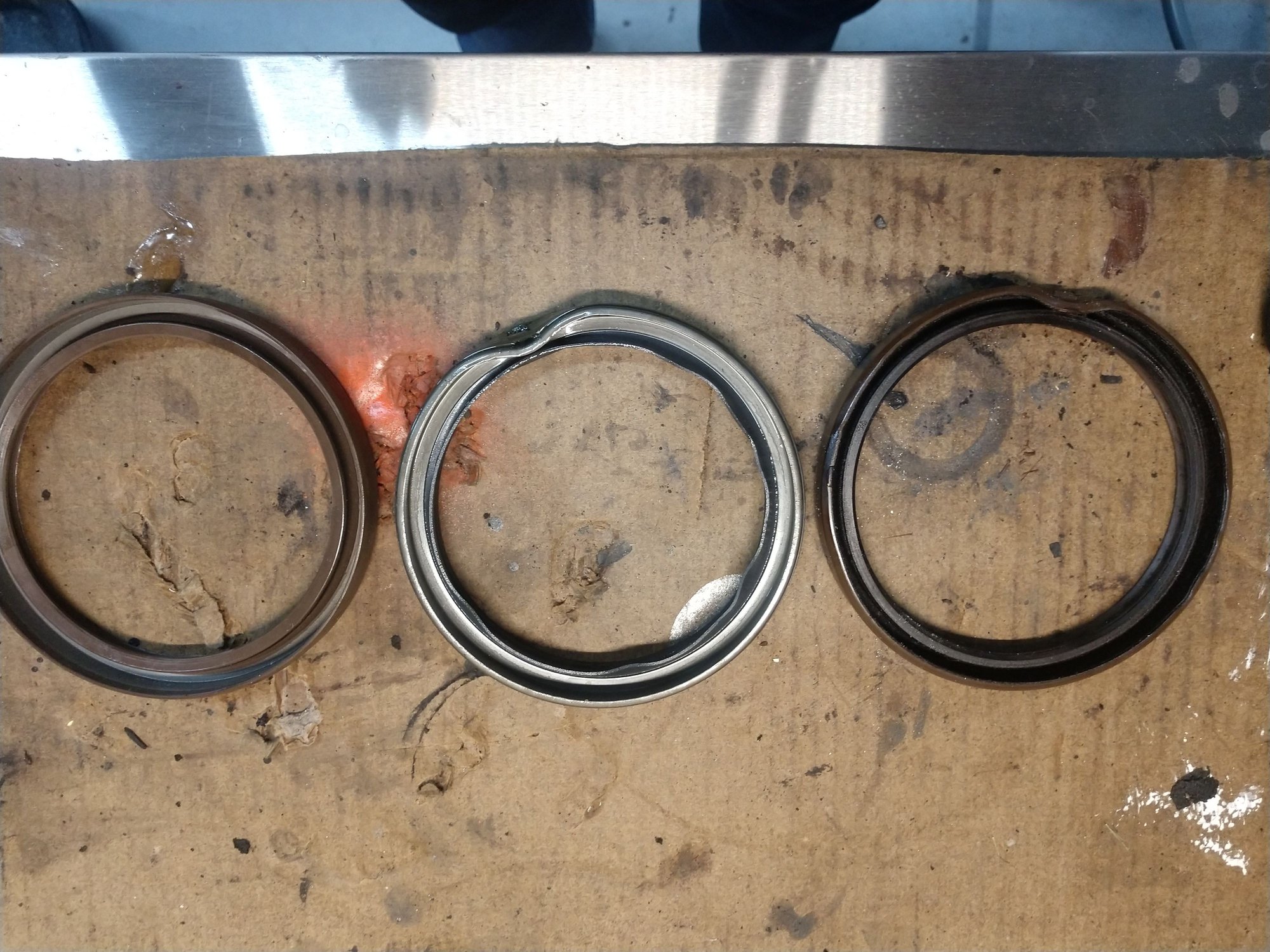

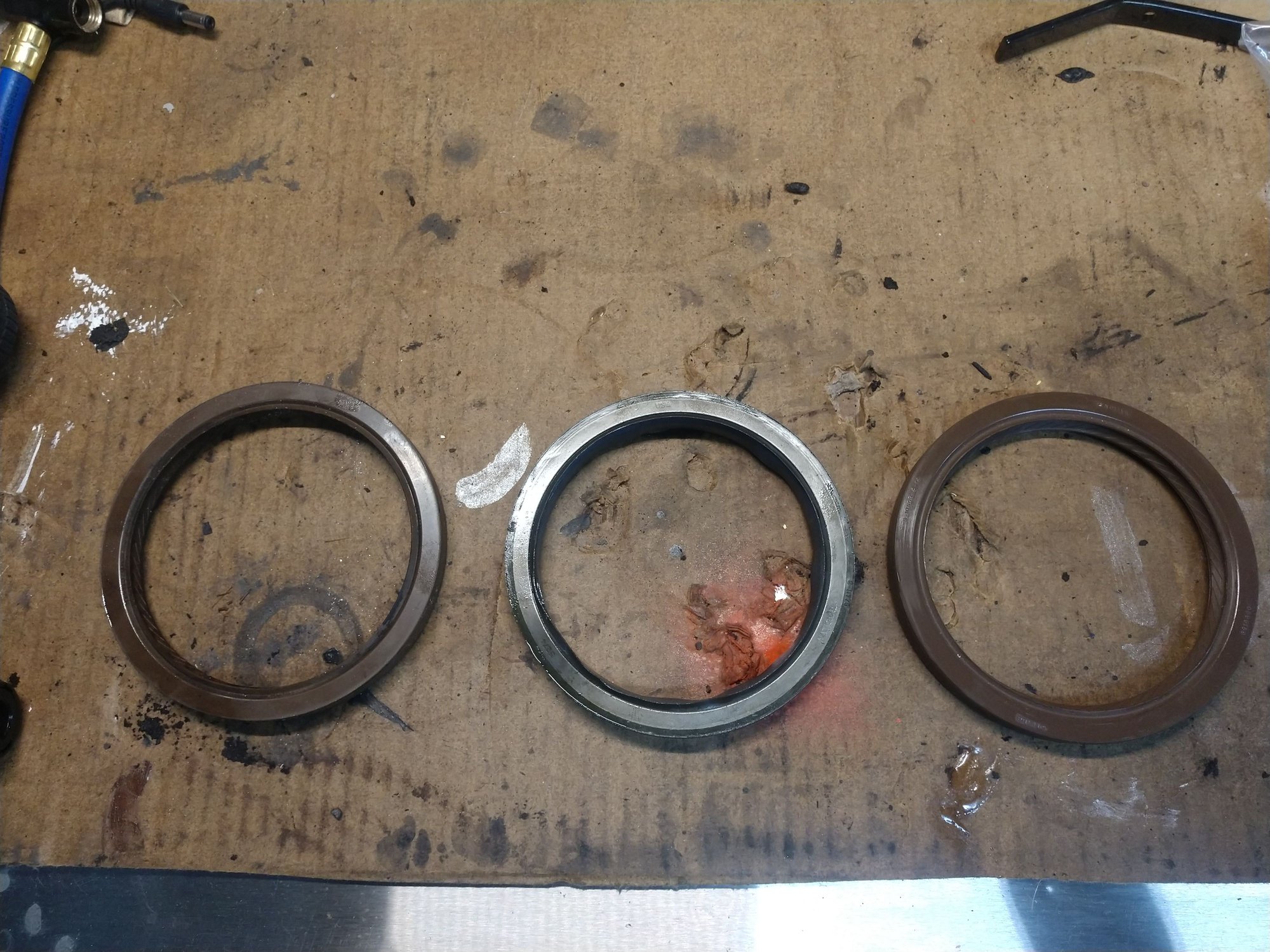

I installed the Felpro seal as instructed.. dry.. but the flimsy installation sleeve broke as i was trying to push it on. so i installed it by hand.. carefully seating it slowly going around the perimeter. it looked real good once installed... not crooked, but flush and smooth...
The oil pattern on the inside of dust cover really looks like a rear main leak to me....
So who can give me better tips on how to install the seal, clearly something went wrong on this install. And its not that the seal did not go in square... I need to know what to do right before i tear this thing apart AGAIN...

You need a tool to push the seal into place. A PVC pipe cap the same OD as the seal usually works well, the goal is to push it in evenly without causing the garter ring spring inside the seal from popping out of it's groove. If you tap one side, then the other, you'll probably have problems. If you hammer it in, you'll probably have problems.

The rear main seal housing also must be properly centered on the crank. Ask me how I know.....
Check with some calipers. Needs to be centered within about 0.005"
No real trick to installing. Be carful with it. I prefer the Viton seals to the PTFE ones. I just replaced mine today due to the aforementioned housing alignment issue. Tapped it in carefully and seated it with a hammer and a short 3/8 socket extension working my way carefully around it. After correcting the housing alignment of course.

I also tapped around the perimeter to seat it using a socket...it looked really good in place. Did the inner lip rollover? ..not sure.
Again... look at the oil dripping from the flywheel.. look at the oil pattern on dust cover... doesnt look like it coming down from above.
Whenever i get back to this.. so frustrated i moved the car to storage.... i need some time....
I am planning to try Viton next time... this one was PTFE

Don't use the PTFE seals on an older motor or one that has had a PTFE seal on it in the past. The PTFE seals are very rigid and they usually cut a groove into the crank. They also deposit PFTE on the surface (this is why you install them dry)..... they need a laboratory clean, perfectly machined surface to seat well and are not recommended for use with speedi-sleeves, etc. I would install a crank repair sleeve, and a Viton seal and you'll likely be back in business.
I like lubriplate (assembly lube) for coating the lip on the viton seals.

If you walked it in, tapping around, you probably done messed up, A-A-Ron. Look at the special tool in the book. Ideally you want to push the seal in with constant pressure around the entire seal.

Ok... update.. after taking a couple weeks off to settle my frustrations, I was back at it with a new seal. Dropped the trans, changed the seal, and put it back together in 4.5 hours... not too bad now that i know what i am doing.
Some notes:
- It is definitely NOT the freeze plugs or oil galley plugs. Bone dry in those areas. Have pictures.
- It is not the oil pan gasket, i put a lot of ultra black RTV on this area and it was still good... but visible oil dripping from the rear main.
- Getting pretty good with 3 feet of socket extensions... works really well. Almost easier that the second bolt on each side.
- 4 inch PVC caps are too big for the seal. 4 inch pipe is just right. I used 3 inches of pipe glued to a cap to give a good even surface to tap on. made it flat and true
- Cleaned up the sealing surface on the crank with emery cloth... saw this as a recommendation to give the seal a fresh clean surface.
- Just a slight lip on crank sealing surface from past wear... just enough to catch a nail
- Bought a viton seal this time.. National brand from RockAuto
I noticed something about the seal i removed...(the first replacement)... it does not look as good a seal as the new replacement... look at the back of the seal
Front side... original on left, first replacement in middle, Viton replacement on right above... Picture flipped below...
The Viton replacement on left above looks just like the one that was in there originally (far right above). Much better back lip. Both have the radial spring on the inner lip.
The first replacement i bought from RockAuto (cheaper) was branded as FelPro and does not have the radial spring and the inner seal is flimsy at best.. see that deformation? Thats just from my fingers pushing on it. You don't get that with the other two. It stays tight and round.... It also doesn't have those oil control grooves... This was cheaper but it doesn't seem like it would ever work in this application.
No, i did not start the car to see if the repair work... i was feeling too good and didn't to ruin the moment... but its coming.

Middle seal looks like it doesn't meet OE specs, w/ no "Garter Spring" !

Did you look around to see if the spring popped out during install? That can happen when tapping seals in place.

The middle seal is a PTFE seal. They don't have garter springs. They need to be installed dry with a VERY clean and VERY flat seal surface on the crank. When they startup they deposit PTFE (teflon) on the crank surface so that the "seal" is effectively teflon/teflon and theoretically should last forever...... in practice though they end up eating into the crank due to the lip being stiff and contamination of varnish, carbon, etc from the engine oil.

Started the car tonight....so nervous I was shaking....Success!!!.car ran for about 15 min without a drop of leakage.
I ran it still up on ramps, without the torque converter cover.... afterwards I crawled under to take a look...no drips...put the cover back on and got the car down....
I have only had success with viton seals on all my cars...and always clean the surface with Emery...

Why do I always have to do rear main seal more than once?...but now I know the tricks for both one piece and two piece seals.... Prep is so important..and cleanliness.
Seal retainer was not an issue...the design of that epdm seal sucks... Use a seal that matches the one you already have... It makes a difference.
