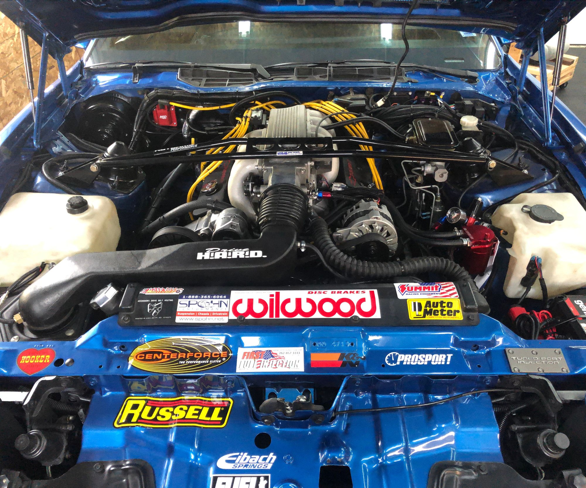

It's Firewall mounted
2020 New 383 Stroker
