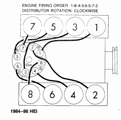

Have you double checked your firing order, or just made sure wires are all to and from the correct locations? 99.9% of the time you see a problem pop up right after you do work, the problem is with that work. If that is good, is the shake only present when idling or does it get better/worse with rpm? Are you down on power? Is it able to drive at all?

Haven’t driven it yet but doesn’t seem down on power. I also have it set at 9 degrees timing. If that helps. I did an hei dis swap from comp control to vacuum advanced and I’m wondering if they are off. My problem is figuring out which post on the dis would be number one. Wondering if I may have set it on 2 or basically one to the left or right of correct timing order. But every time I look at it I feel it’s right but something tells me I’m wrong. Thanks again. also tried every advance/retarded degree you can. Nothing made a difference. Just continues to shake any help is appreciated. I’m stumped to the point I’m about to check the motor mounts.

As the factory assembled the motor, the #1 post is at the front, just to the driver's side of center. If you put it back like that the plug wires will lay in place better than any other orientation, but it ultimately doesn't matter to the way the engine runs. As long as the rotor points to the right plug wire when that wire's cyl wants to fire, life will be good. If ugly maybe.
I completely agree with the firing order as a likely cause. It's SOOOOOOOOOOPPPPPPPPPPPPPER EEEEEEEEEEEEEZZZZZZZZZZZY to get 8 & 4 crossed, or 5 & 7. I'd suggest that you take all 8 plug wires off, and put them back on one at a time, NOT jam all 8 in the cap and "route" them or pork all 8 onto the plugs and "route" them that way either; take all 8 off, and start with #1, and ONE AT A TIME, install them so that they are KNOWN to be on the right plugs. NOT "look"; NOT "check"; NOT "I'm sure"; NOT NOT NOT NOT NOT NOT NOT NOT NOT NOT NOT NOT . PUT THEM from the right terminals to the right plugs, one at a time, one end to the other, one at a time. One at a time. Oh, did I forget to mention, ONE AT A TIME? In case I forgot, the way to do it is, ONE AT A TIME. #1 cap terminal to #1 plug, with NO other wires present; #8 terminal to #8 plug, with NO OTHER WIRES PRESENT, except the #1 that's already there; and so on, all the way around the cap. Just like I used to train people that literally came off of cotton fields into my factory where we wired up assemblies that had THOUSANDS of wire EACH: wire goes from here to there; if you are running a wire, and the place you get to already has a wire, STOP, because YOU JUST EFFFFED UP something; we supplied a list of terminals that should have no wires at the end, and if you wired the whole thing and didn't encounter a wire already on a terminal, and at the end all the terminals that were supposed to be empty were in fact empty, you could be DAMN NEAR 100% SURE you had eon your job right, even before any kind of electrical "checking".

Since you have basically a completely new ignition system, newly installed and running (albeit like crap) the low hanging fruit is crossed wires. Mounts won't cause a shake so that's not an issue. I second sofa's advice on wiring from the start, one at a time, so you know for an absolute fact the wires are correct. Let us know what you find.
