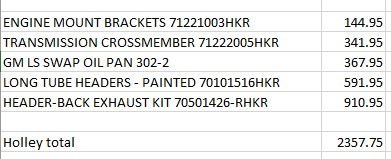

I've been doing my own research regarding an LS swap. Maybe the OP can get a realization of the cost involved just to get into the LS game. No hot rod engine here. No other chassis upgrades.
This is the most basic approach I can conceive without any "custom" fabrication. I.e. exhaust. The items in the attached list are part of Holley's swap system and are meant to provide a low fuss fitment.
It doesn't take into consideration the cost of the engine. Nor does it address the fitment of (in my case) the LM7 from my spare parts truck (03 Tahoe). There are various accounts as to whether the tall truck intake will fit under a stock hood (the general word is no) however I've a cowl hood. There is also an issue with the truck accessory drive. Namely the high centre mount alternator. Not sure about that. The AC is also an issue but this is a no AC deal here.
That said, this is an entry level representation as to the parts involved. Radiator, or more specifically, rad hoses can be sourced from bits and pieces and from some accounts, made to work with the OEM rad.
The factory PCM would be reused and all configurations are as they would be in the truck. Mods that require tuning and the tuning itself are not part of this initial step. It's simply to get the engine in and running. And probably running without a hood (but we've all done that right?)
Personally, I'd ditch the stock intake and EFI and drop in a carbed intake. Then get a stand alone ignition controller. But that's another story.
The basics follow. Naturally as with any work of this type you have to factor in the consumables and wear items. Fluids, belts, etc. would all have to be addressed but that's another list.
I should add that this would be installed with a 4L60 transmission. Much easier than a manual transmission swap. And less expensive but you have to add in the cost of the LS to 4L60 adaptor. About 150 bucks. I have the transmission. Remember that this is my list but the OP can take away from it an idea of the cost.
