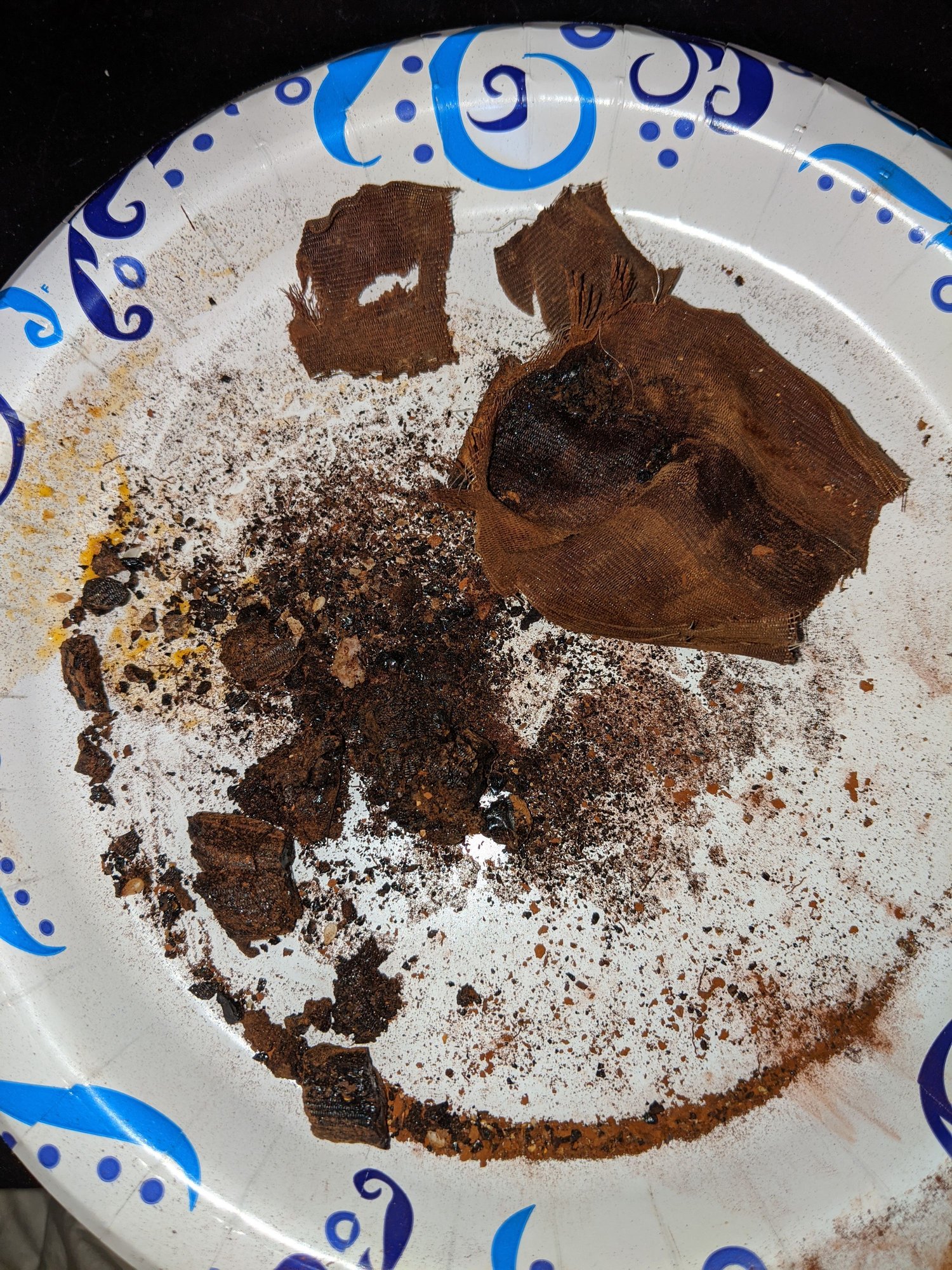

Just in case someone should find this thread due to a similar circumstance I have found out that.
1. They haven't made new ones in over a decade.
2. You can get a remanufactured one at hawkmotorsports but when you see the picture of it the price is $320 but when you click on unit it turns to $395. To rich for my blood.
3. Clean out your old one by taking apart the sender.
4. Rig one up using a fuel pump one without the fuel pump.
As you can see in the pics that my sock had all sorts of crud in it. Literally chunks of goop.
My sending switch was also gooped up with alot of rust. I did thoroughly clean it but the 0-90 ohms is still way off for now.
Mass of chunks gooped up the fuel sock
