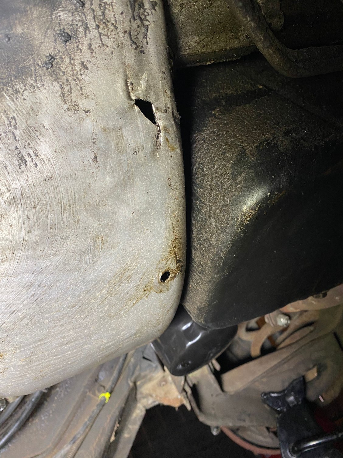

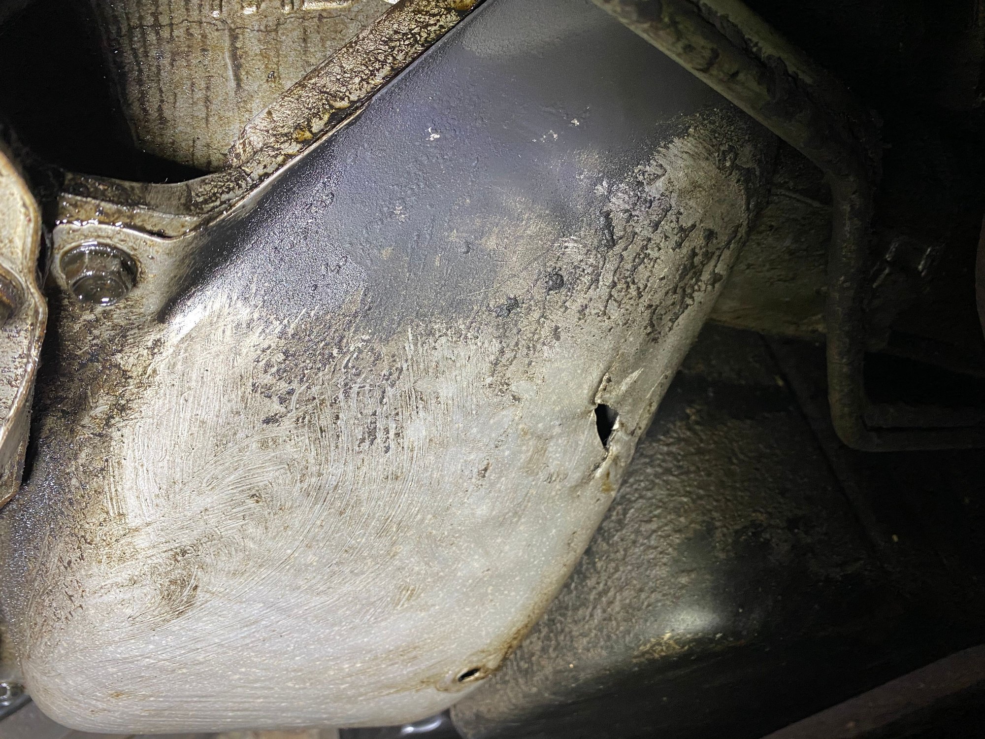

I was under my new to me, but which needs a lot of TLC, 83 Camaro fighting a stuck o2 sensor when I noticed two holes on the cover in the pic below. What is under that cover and how should I go about fixing the holes? The pics are from the passenger side. It’s right up against the oil pan.

It's the torque converter cover.
The holes don't really matter. The nice pretty round one at the very bottom in fact is a drain hole.
Looks like you need a can of engine degreaser and a trip to the quarter car wash. A wire brush isn't the right tool for what you're trying to do.

That is the cover that goes over you fly wheel keep stuff from getting wrapped around it and stops stuff from hitting it and bending it . The round 1 is the factory hole to let fluid and water run out. The other is from hitting something. It did its job. I would think your best option is to find a new 1 at junk yard not sure you can weld that thin metal.

Thanks for the info. I never did find a home for the mystery connector. Everything I looked at already had something plugged into it.
As soon as I get this drive-able again, that’s exactly what’s going to happen!
