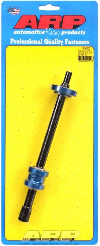

Long rod - oil pump priming tool. But it's almost useless. It needs to have a distributor lower housing to complete the pass bank llifter oil gallery.
Like this:
Shorter black shaft - intermediate shaft between oil pump and distributor.
Home-made silver thingy - yeah, I can see that being an oil pickup installer tool.
