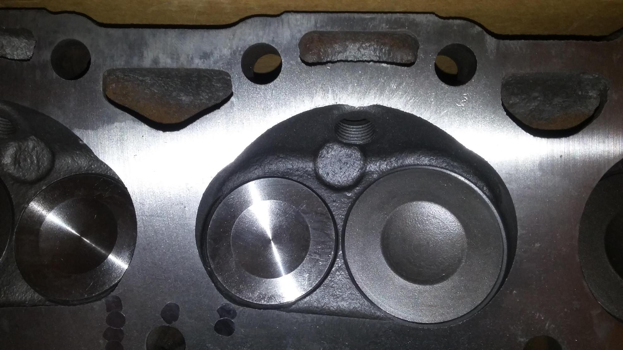

Heads are in! They came with upgraded spring retainers, too. Probably still gonna swap them out for the LS springs and adapted retainers. The valves are definitely slightly larger than stock, so that's nice. Looks like they made them as large as possible without seriously affecting chamber size/shape. They did come in a little dirty (I think it's leftover lapping compound stuck in the runners- grey and gritty) but that's alright as I'm going to be disassembling them for cleaning anyway. Overall pretty pleased so far, it appears to be a decent upgrade for only $30 markup over the regular 601 heads.
Edit: It's oil. They put oil on the head to protect it from rust. I'm an idiot.

Got a picture here;
No idea what those little 'dimple' looking marks are for, but they're perfectly flat with the rest of the head so who cares, really.
