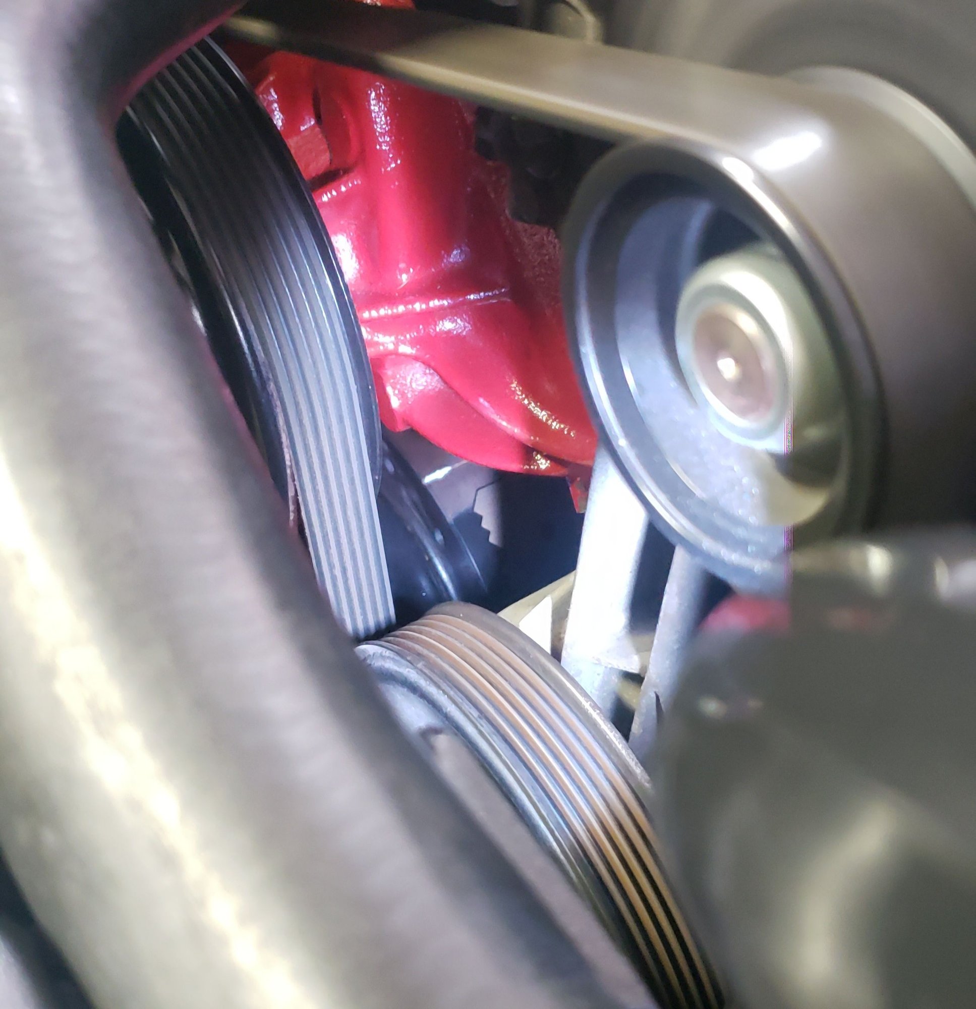

Not too sure what happened, managed to get a pic of where the timing is at, is this too high ? When I disconnect the est base is still set at 6°btdc, it maintains this level of advance (in the pic) when connected, idles at around 750/800 in park, I still can't test drive it yet but it feels like it has a little hesitation when I tap the accelerator....
If you are at 6 BTDC at idle with the distributor wire disconnected, that's correct. When you reconnect the wire, the timing will advance.
